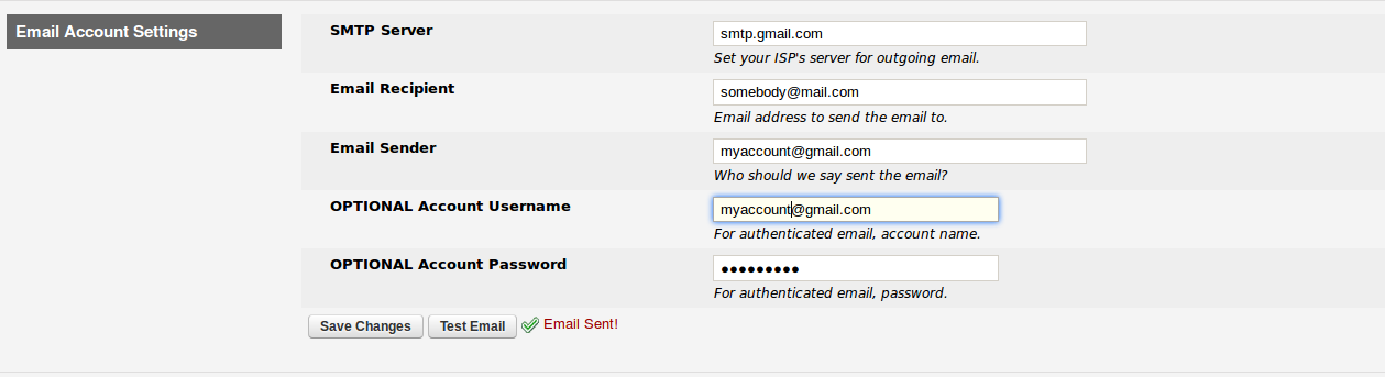

Mine works just fine just tested sending an email from within Sab, I am using gmail for this, what are you using?
see my screengrab
I am using gmail as well.  I think I got it.  In the Sab I had on my desktop I didn't need to fill out the "Email Sender" with an email address and my "Acct. User Name" was only SOMEONE noy [email protected].  I switched it all to my email address and it seems to be working.  The test email went out so the rest should follow now.
