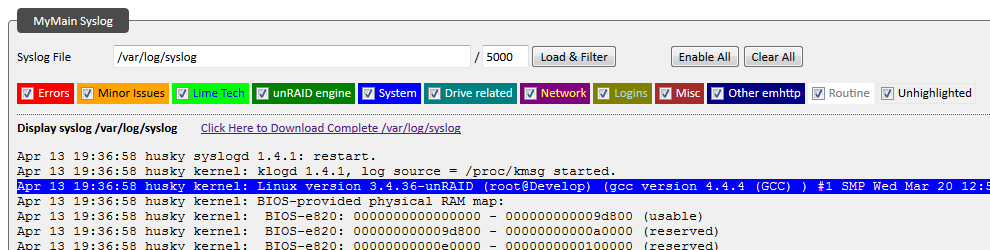

Alright, redid the syslog legend a bit on the 'syslog' page specifically. The rest of the syslog legends were untouched...  ss attached.
Updated a few files and added the CSS to each of the 3 files..  to make it easier on everyone I just zipped the modified files.
UtilityShell.html
unmenu.base.lib.awk
unmenu_classic.css
unmenu_horizontal.css
unmenu_vertical.css
enjoy!
--z
unmenu-syslog_update.zip
UtilityShell.html
unmenu.base.lib.awk
unmenu_classic.css
unmenu_vertical.css
enjoy!
--z
UtilityShell.html
unmenu.base.lib.awk
unmenu_classic.css
unmenu_vertical.css
enjoy!
--z

Joe, you had a chance to test out latest changes? all good?
These latest changes are now tested and uploaded to google.code.
As usual, check for and install them, then to see the new (slightly larger) labels on the syslog page you will need to re-select the style of skin on the user-scripts page and also re-start unMENU.
Joe L.
