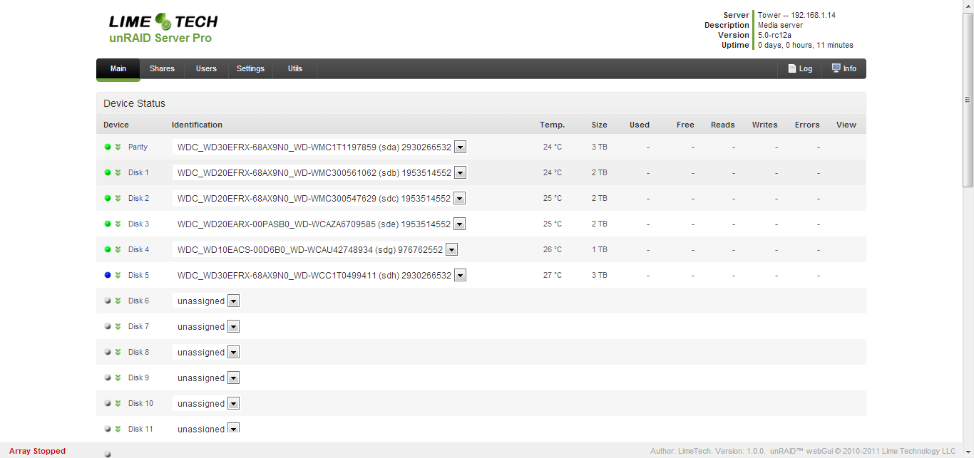

The new drive is visible and selectable under the unraid gui (shows as WDC_WD30EFRX-68AX9N0_WD-WCC1T0499411 (sdh) 2930266584). I assign that drive to the array, check the 'I want to do this' box and click START to start array however the page just refreshes immediately and nothing happens. The array doesnt start and no other changes occur. I expected to be able to format at that point.
If I unassign the drive and click start the array starts perfectly as normal.
The syslog is attached - I think these lines show something but Im not sure what. From reading the preclear.sh thread it seems like you still need to be able to start the array to use the utility to preclear a disk.

Im pretty sure nothing is happening with my system. After assigning the new drive and clicking start, the page refreshes instantly and the start array button remains available, the checkbox is cleared and can be re-selected and the drives can be assigned/unassigned via the dropdowns.
I can then unassign the drive and start the array with the normal drives.

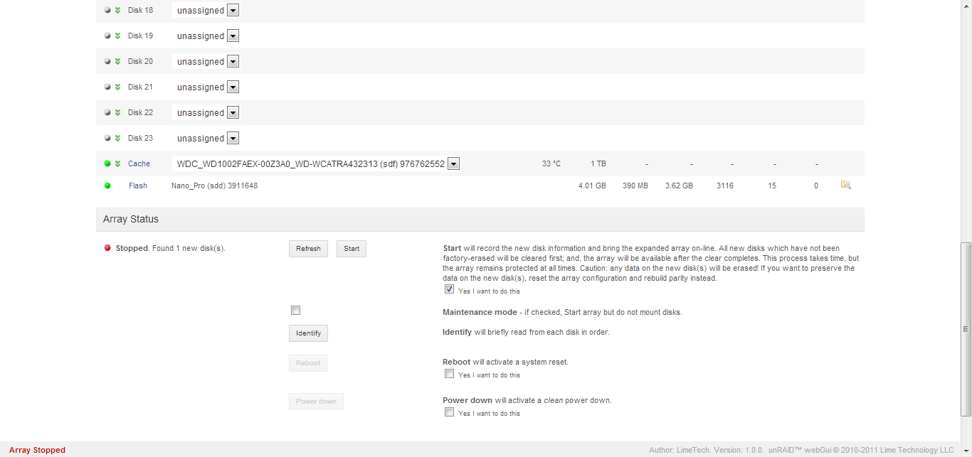

See images for the v5.0 options, I don't believe there is a Clear Button.
I would certainly expect that the status would no longer be "Stopped" -- and that there would be SOME indication that the drive was clearing.
Hopefully someone who's actually done this with v5 can chime in with just how it SHOULD look.
But I agree the indication seems to be nothing is happening -- otherwise it shouldn't let you do other actions without at least canceling the operating.
