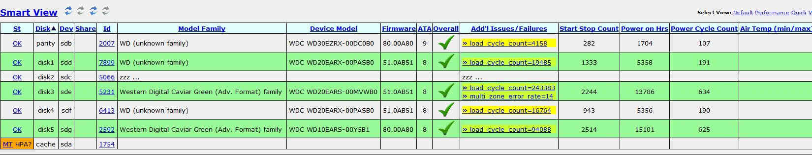

I recently got hold of an M1015 flashed it to IT mode and successfully installed it in my system, On this controller i have a single drive a 500GB Samsung i had laying about and started using it as a cache drive.
I thought i would try unmenu since its updates as was just using SF and a couple of plugins and to my surprise when i looked in mymain i notice it reporting HPA on my cache drive.

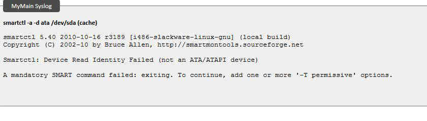

I'm also unable to pull a smart report off for the drive using mymain but i can in SF for some reason.

If you want to get a smart report off a drive connected to an M1015 you need to do this.
That's because your SATA controller objects to being told to behave as a PATA/IDE controller (the -d ata switch in the smartctl command line).

Again, the solution was posted, all you need to do is set the myMain "smartopt" disk parameter to "-A" (without the quotes)
It is explained here: http://lime-technology.com/forum/index.php?topic=9337.msg141761#msg141761.

Your HPA may just be because the parameters for it are not loaded in mymain - but someone more knowledgeable should confirm.  In any case to turn off the warning follow this procedure.
Is it OK to just turn off the HPA warning, I dont want to turn it off if there is a real problem :(
Your syslog shows no warnings about an HPA, you are safe to disable the warning in myMain.  It is occurring only because it has no listing in its config file that matches the "size" of your 500Gig drive.
Thanks Joe thats all i need to know, keep up the great work
