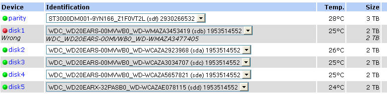

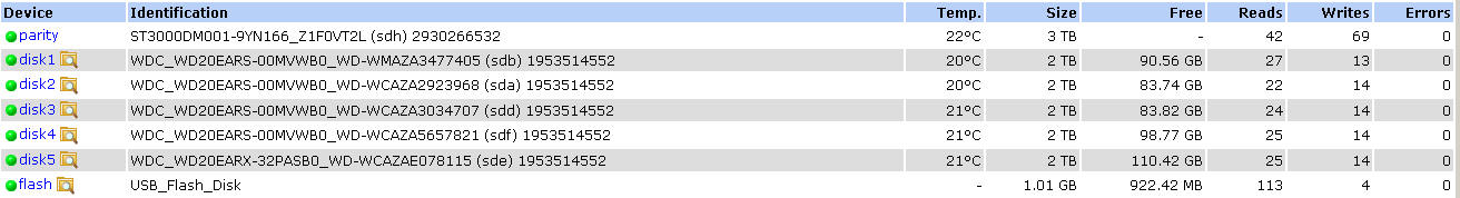

Thank you guys - embarrassed - I missed that disk 1 had pending sectors. I've now run self tests on all the drives and no other drives have pending sectors.
I'm up for a parity-swap-disable - let me check exactly how to do this in 5.0:
Currently parity = 3T
Disk 1 = 2T EARS with pending sectors
And I have an old (good) 2T parity - connected and unallocated
Disk allocation screen grab attached.
1. Disconnect the pending sectored 2T disk 1
2. Connect the 3T parity drive as disk1
3. Power-on the server
4. Assign the 3T drive as parity and the old good 2T parity drive as disk 1.

Thank you - taking this slowly ...
1. disconnected 2T disk 1 with pending sectors
2. started array - disk 1 red balled missing: good
3. powered off - disconnected 3T parity
4. started array - parity & disk 1 red balled missing: good
5. moved 3T parity to SATA connector for disk 1
6. started array - 3T still found as parity - I expected it to stay red-balled.
7. assigned old 2T good parity as disk 1 - disk1 still red-balled as wrong drive (screen grab attached)
8. about to start array, but dialogue says 'Start will bring array on-line START DATA RE-BUILD etc.' (screen attached)
This looks like it will use the 3T parity to reconstruct the old disk1 image on the old good 2T parity drive
As the 3T parity is affected by the read errors on the now disconnected 2T with pending sectors I don't want this.
Do I tick Yes and Start, please?
Well, Parity Swap Disable didn't take me anywhere, so I left the 3T parity connected and the failing 2T as disk1, and added a 3T disk6. Then:
1. copied disk1 to disk 6 http://lime-technology.com/wiki/index.php/Transferring_Files_Within_the_unRAID_Server
2. Utils/New config
3. unassigned old disk1, assigned the 3T that was disk 6 as disk1
4. started array, cancelled parity build
5. removed failing 2T and installed on Windows machine
6. surface tested extensively with HD Sentinel Pro
7. discovered which files on 2T were on poor sectors
8. recopied affected files from backups to unraid
9. built parity
10. and checked parity - all ok
For the failing 2T drive,
11. reallocated weak and pending sectors in HD Sentinel
12. formatted drive as 2 volumes with a 3 cylinder-wide raw partition covering the poor area
13. now using the old 2T drive for off-site backups - I surface check all my backups very 3 months looking for changes and i my experience drives with local weaknesses can be fine so long as carefully mapped around and regularly checked.
This procedure isn't optimal as there's no parity protection for a while but as I have double off-site backups, I was ok with the risk.
