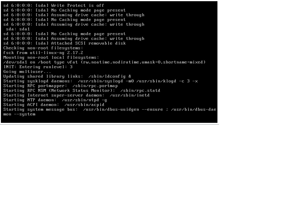

I fired up IPMI and started the X8SIL-F. It booted from the USB stick, saw the unraid startup on the IPMI iKVM console, and then it stops. It won't continue to the unraid login prompt.
It stops at a point shown in the picture. Is this because the unraid configuration is invalid? Should i delete the super.dat? Or should I create a new unraid stick?
