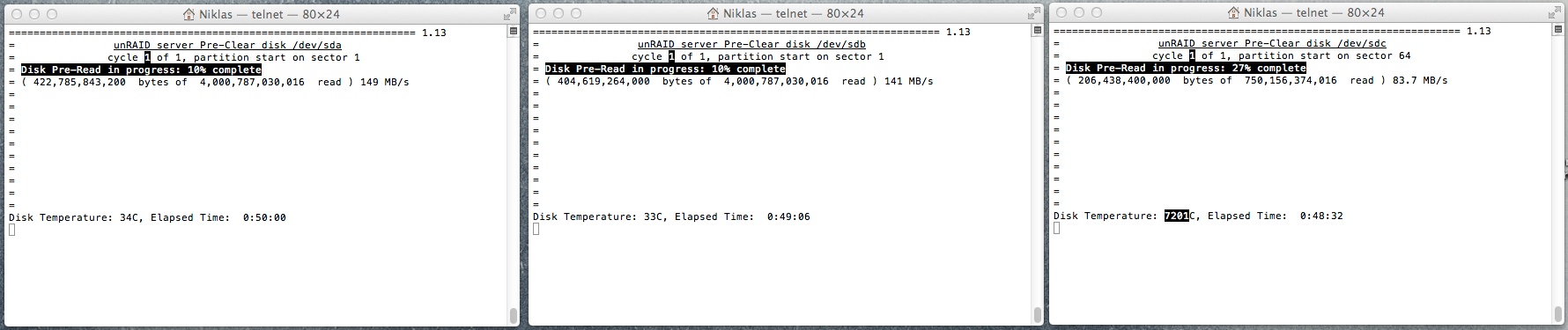

I´m trying to run a preclear again. Attached is a screenshot. Even if the 2,5" WD Cache wasn't the problem it still looks weird with that temp (7201 degrees celcius). The other 4TB 3,5" looks OK so far...
By the way, should the "start on sector" be different like in the pics?
