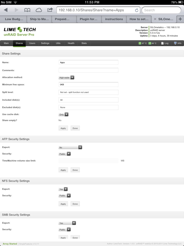

July 31, 201313 yr I created a cache only share called Apps, but found that the Apps folder also appears on my main array. It's on disk1, 2 & 3. Just empty directories, no files. Is this normal? Is it safe to remove the Apps folder from my disk1, 2 & 3?
