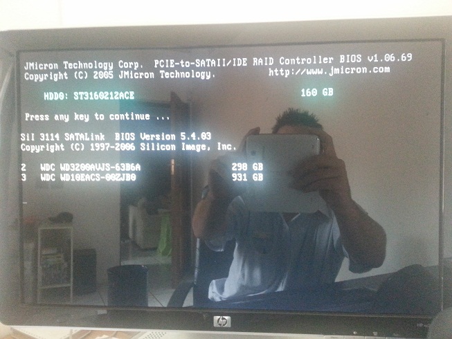

Ok. I think I may have found the issue. I have an SiL 3114 sata card that two of my hard drives are plugged into. I just tried restarting my Unraid box and it hung on the Sata card screen. This is just before where it would normally start booting from the unraid flash.
I have attached the image to this post.
If I unplug the Sata cables from the card to my two hard drives then it will get to the unraid boot screen at which point I switched off the PC.
I have already flashed the bios on this card to get it working with unraid and it has been working fine for a good 3 months. Could this have been causing the issue? Is there anything I can do to fix it?

Sounds like that's the issue -- you simply need to replace the card and all should be well.
