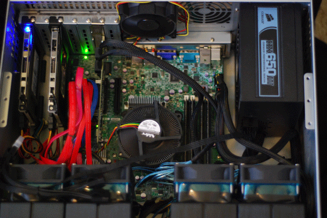

The case I'm using is an 8 bay 4U iStarUSA case:
So I used the 3-in-2 models:
... to make a 12 drive trayless system. Modding the 70mm to 80mm pwm fans was simple enough with the shroud. Taped up the air gaps, and voila. I use a custom fan speed script to keep my drives between 32C and 36C. My drives are 5400 rpm, and during a parity check the fans run between 70% - 80% to keep the drives around 33C-34C. I could keep them cooler, but the infamous Google drive failure experiment showed me there is such a thing as keeping your drives too cold.
I had assumed that was the case (the 3-in-2's), based on the details at Newegg.  But I didn't see how you got 10 drives (like the new Limetech server) ... which I assumed (incorrectly) was what you had [based on "... I use those exact iStarUSA drive cages in my server ..."].
Temps are good -- I'm sure bumping the fan size up, coupled with thermostatic control of the fan speeds, is what allows that.    I've tried several different 5-in-3 cages, and while they generally work fairly well, what I've been using in more recent builds is the simple CoolerMaster 4-in-3 cages (not hot swap) that have a 120mm fan in front => this keeps drive ~ 4-5 degrees C cooler than any hot-swap I've tried, with very low (i.e. silent) fan speeds.  A side benefit is they're a lot cheaper  :)

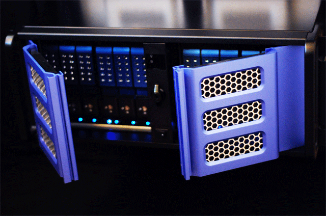

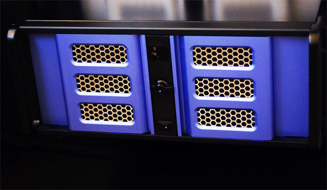

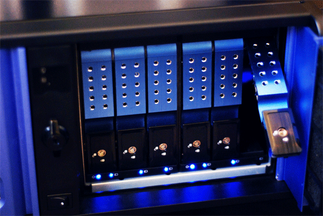

I guess I should have made a build thread like others have done. But I put this server together before Raj started his UCD threads, and haven't taken it apart to do proper documentation. Here is a pic of the inside. You can see the spacing between the 80mm fans is as good as it gets for the 3-in-2 models. Also, it shows there is room for 4 of the PCI drive enclosures and still add 2 SATA controllers. The red/blue SATA cables are doubled over and are attached to the motherboard. If I had the desire to clean things up, I would buy shorter cables. If I add a second controller, I will have to do better cable management. Also note that I still can add another exhaust fan, but haven't had a need thus far.
Pic of the front.
Another. Yes, technically those drive enclosures are "upside down". But the drives spin exactly the same, and it was necessary to get the modded fans above the motherboard for a proper fit. It also means the exhaust from the drive cages goes straight along the top to the vents in the back of the case.
All closed up and locked.
