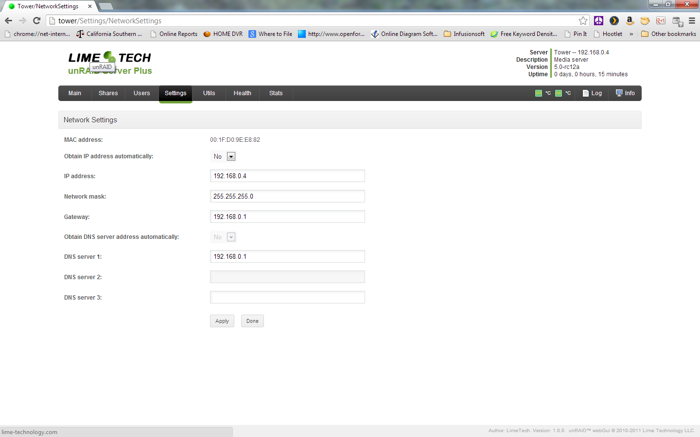

Post a screen shot of the network config settings.
Here ya go.
