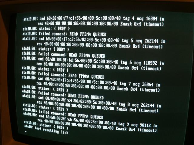

Fortunately the monitor showed me this (attached jpg) even though the keyboard was unresponsive.
That is showing a disk that has stopped responding.  (can't tell which once from the screen-shot)
Could be as simple as a loose/bad cable to the new drive, or you might have loosened a different cable to a different drive when installing the parity drive.
Or, the new disk might have died an early death.  Do not be surprised when you reboot to find a disk disabled/missing.

Well, it sure sounds as if you had performed the steps you could prior to the upgrade.
Most likely then is a cable that has come loose on one of the drives.

(b)  It sounds like you did everything fine ... I agree with Joe L that you've most likely just had a cable come loose.  Reseat (unplug/re-plug) both the power and data cables for your drives (especially the new parity drive and any others you may have moved around in the process).
... or if the drives are in a hot-swap cage, remove and reseat them

It looks like Murphy has struck and disk6 (WDC WD20EADS-00R6B0) is failing (8 weeks out of warranty).  I tripled checked the cables on all of the drives and they are good.  A Smart check shows this on disk6/sdb:
197 Current_Pending_Sector  0x0032  200  200  000    Old_age  Always      -      44
198 Offline_Uncorrectable  0x0030  200  200  000    Old_age  Offline      -      14
So disk 6 definitely appears to be the issue.  My big question is whether I should bother trying to get parity rebuilt with it?  My crappy alternative is to buy another 2TB drive ( :( ), swap disk 6 out, and then upgrade to the 3TB drives I have.  Ideally parity would rebuild on my new 3TB drive on one attempt and then I could just swap the 2TB disk6 with another already precleared 3TB drive.  Or can the errors on drive 6 and the missing parity drive cause a "bad" rebuild?  It's still chugging along despite the errors so I'm thinking it could finish if the planets align (trying to be a glass is half full guy).  Also the fact that it somehow finished a parity check yesterday on 4.7, tells me it can occasionally cross the finish line. :)

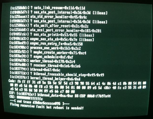

Second parity rebuild was successful.  Immediately replaced disk6 with my second 3TB drive and started a rebuild .  Came home to find this kernel panic.  Sounds like something to do with my SATA card.  Is rc12a not compatible with the AOC-SASLP-MV8?  Will try rebuilding again.
Thanks
RC12a is compatible with the SASLP-MV8. Tons of people on here have that card, including myslf.
Have you tried running memtest86 to make sure your RAM isn't bad?
