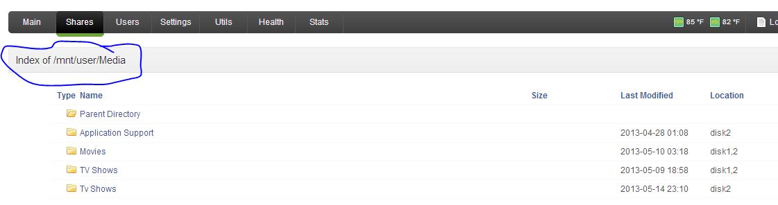

Randomlly a few days ago, I notices a new folder under the Media Share called "Tv Shows" (lowercase V).
THe contents appear to be identical between Tv and TV.  THe file size and number of files is the same (when viewing in windows).
Ive restarted the server, still shows up.  Checked all plugins...and do not see anything mapping to Tv.
Does anyone know what could have happened?
Check your individual disks and see if there's a "TV Shows" folder on one (or more) and a "Tv Shows" folder(or folders) on another.
I don't believe shares are case-sensitive ... so they'd both really be the same share;  but if one of the folders somehow was created with the lower-case v, it could (in fact apparently does) result in both versions being displayed as shares (although they both refer to the same things).
If that's the case, re-naming the offending folder on the disk(s) involved should resolve this.
... by the way, if that IS what happened, it would be interesting to know WHY.
Have you written directly to one of the disks instead of the shares?
Did your current allocation method result in a recent switch to a different disk for the writes?
Which applications are involved in writing new data to "TV Shows" ?
Did you by chance do a copy to the array and manually type the name of the share?  (perhaps inadvertently typing "Tv Shows")
