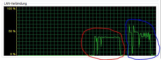

I also noticed that writing to a cached share or a cache-only share is as Slow as writing directly to the Array. If I write Files directly to the cache disk share, the Write Speeds are as expected, about two Times faster than writes to the Array. The Files are definitley only written to the cache drive, as the read/write counter for disk1 and parity in the webinterface doesn't rise during writing.
What could be the reason that writing to a cached User share is as slow as writing directly to the Array? (20-25mb/s) while writing to the cache Disk share is a lot faster? (40-60mb/s)

But the last test gave me some interesting results. I booted up windows 7 on the same machine (macbook pro) and connected to several shares on my unraid server. The first thing I noticed was that the directory view was muuuuuuuuch more responsive. I clicked on a folder and it opened without any delay, while on mac os it sometimes takes several seconds. By the way, the handling of network shares in windows 7 is much better than in mac os. Then I transfered a mkv file (1.8gb) to a cache-only share and got pretty stable transfer speeds in the low forties. (42-44mb/s) After that I transfered the same file directly to the cache-disk and got a slightly better, but highly fluctuating speed (around 49mb/s). (shown in the picture) I have to mention that my cache drive is a pretty old 250gb 2.5inch laptop drive that won't provide any better performance. I'm pretty sure that changing that drive should give much better speeds. So this is the exact behaviour I would expect from unraid, except the fluctuating speeds.
In Mac OS I get these fluctuating speeds all the time. I tried the smb share in mac os after that and got slightly better speeds than with the afp share, but not as good as in windows.
I had a netgear nas before and it was highly responsive in finder, like unraid in windows. I never compared the write speeds between windows and mac, because I never had any issues with that device and got stable write speeds in the high 40s.

I have a cache-only share called "Cachedrive". I'm absolutely sure it doesn't write anything to the array. If i write to \\Tower\Cachedrive in mac os I get those slow write speeds. If I write to \\Tower\Cache I get the speeds I would expect when writing to the cache drive. Anyway, in both cases the write speeds are highly fluctuating under mac os. (down to 5mb/s and up to 60mb/s) Connecting to the same shares in windows works without any issues, so it's definitely caused by mac os, but I have absolutely no idea what could cause this behavior.

I checked the writing speeds directly to disk1 without parity and directly to my cache disk. They were absolutely fine. But as soon as I wrote to a user share, the write speeds dropped to around 25mb/s. Tested with smb and afp.
The issue with slower write speeds to user shares also occurs under windows, but not as rigorous as under mac os. Under windows it's just a few mb/s.
