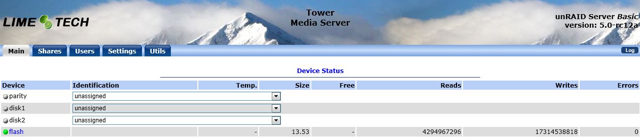

Still seems to be related to mounting the flash drive and or drives. I've tried different drives and had the same results. So I don't think it's my flash drive. I've also tried different usb slots on the MB, same result. I was able to get emhttp manually started and got the web server up. It shows a flash drive but no info. I was able to get another syslog after I started emhttp.

At this point the server isn't "coming up all the way" as emhttp isn't running, it isn't getting to the go script. So the array is showing "Stopped: no devices". I can see my three disks, just not my flash drive which is where are the config is.
