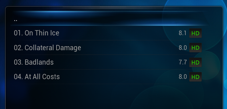

A couple of shows downloaded last night (Falling Skies and True Blood).  They have been added to the library from what I can tell but they are not added like I would expect.  See the attached photo for what I mean.
Basically, the first three were put into the system by using the "update library on startup" while the last one was put into the database via SickBeard and the xbmc salud process.
Does anyone know the reason why the update to the library would be different?

as for the updates, try checking it again. i think it is just the way your xbmc player reads it and not anything to do with the way salud does a library scan. i too have scanned the library and then went to check my xbmc and seen stuff named exactly as your photo is but it was normal when i went back to it a few minutes later.

I will check again when I get home but that example I showed was from this morning.  That show had been downloaded and loaded into the mysql library at about 12am this morning.  I then loaded and looked in XBMC on my Mac this morning.

ok. let me know how it goes. it still sounds consistent with what i'm thinking since xbmc was just only loaded that morning to look at it. in my experience with xbmc, when i view a new addition in the library, it will appear different as you show it. i attribute this so the fact that even though it is in the library, xbmc has not ever displayed this item in the library on screen to the user and has not cached/scraped/whatever the title yet. this seems to me to be an issue with the skin or gui and how is displays the item as opposed to the library update. it always fixes itself for me after a minute or so.
To confirm this, use a mySQL db viewer/editor and look at the entries in the database. See if there are any differences between them.

Yup, it was on my list of things to look at also.

I am using the Aeon Nox skin, simply because I prefer the way it looks and the many different layout options available.  The issue I mentioned earlier is still present after having just gotten home and opened XBMC back up to check.
I did switch to a different skin, Confluence (default XBMC) and it is at least consistent in the way it displays the info, names, and the like.
I will have to get on the XBMC forum and see if someone from the AEON NOX group can help out.
