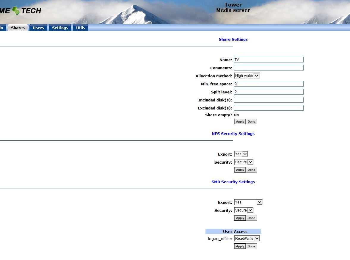

Still I cannot move things around. It seems I don't have permission to access the folders. 'destination access denied' or my personal favourite 'you require permission from Tower\nobody to make changes to this file'
At this rate, unRaid may have a short life expectancy on my system :(
I have attached a snip of one of the shares in case this helps.

Alright, it seems that by making the shares all public again, along with the new log in from the PC, the problem has been resolved.
Still not sure why the shares can't be private but I can live with that for now.
