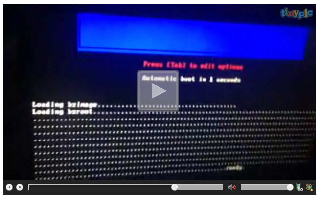

Still i have a problem booting into unraid. I have no disks connected, i've inserted my usb flash drive and booted into unraid. It goes like usual:
loading bzimage..... bzroot................................etc. but then the monitor turns off. I'm not getting the screen where i can login. I do have the ethernet cable plugged in. Does anyone know what i should do here?
Well here's an update, i finally have a working system again. It boots just fine now with the new motherboard & psu, i only had to reset the cmos because the monitor wouldn't turn on.

I also made a video showing how the system boots up http://tinypic.com/r/2wbxs9u/5

What is the word that pops up at the end of the ....... during the reading of bzroot---- just before the screen goes blank?  I can't read it on your posted video.

I don't think you you understood what I was asking.  At the end of the ...........  that bzroot is putting on the screen, I saw what appeared to be a single word and then the screen goes blank.  That word is the one I was interested is know about.
The "no signal going to sleep" message is probably from your monitor going into its power saving mode.
Looks like "Ready" to me.  Assuming I'm understanding your question myself.
Note that is what I get as well at least with 4.7 and 5.0betas not sure about 5.0rc's.
That is what I was having joeykey87 check for.  It makes a difference if it was not 'Ready'!
Correct and when I watched the video it looked like it said Ready to me.
Allright i'll test it again in about 3 hours from now. But even if it says 'ready' then shouldn't the monitor stay on and ask me to login?
