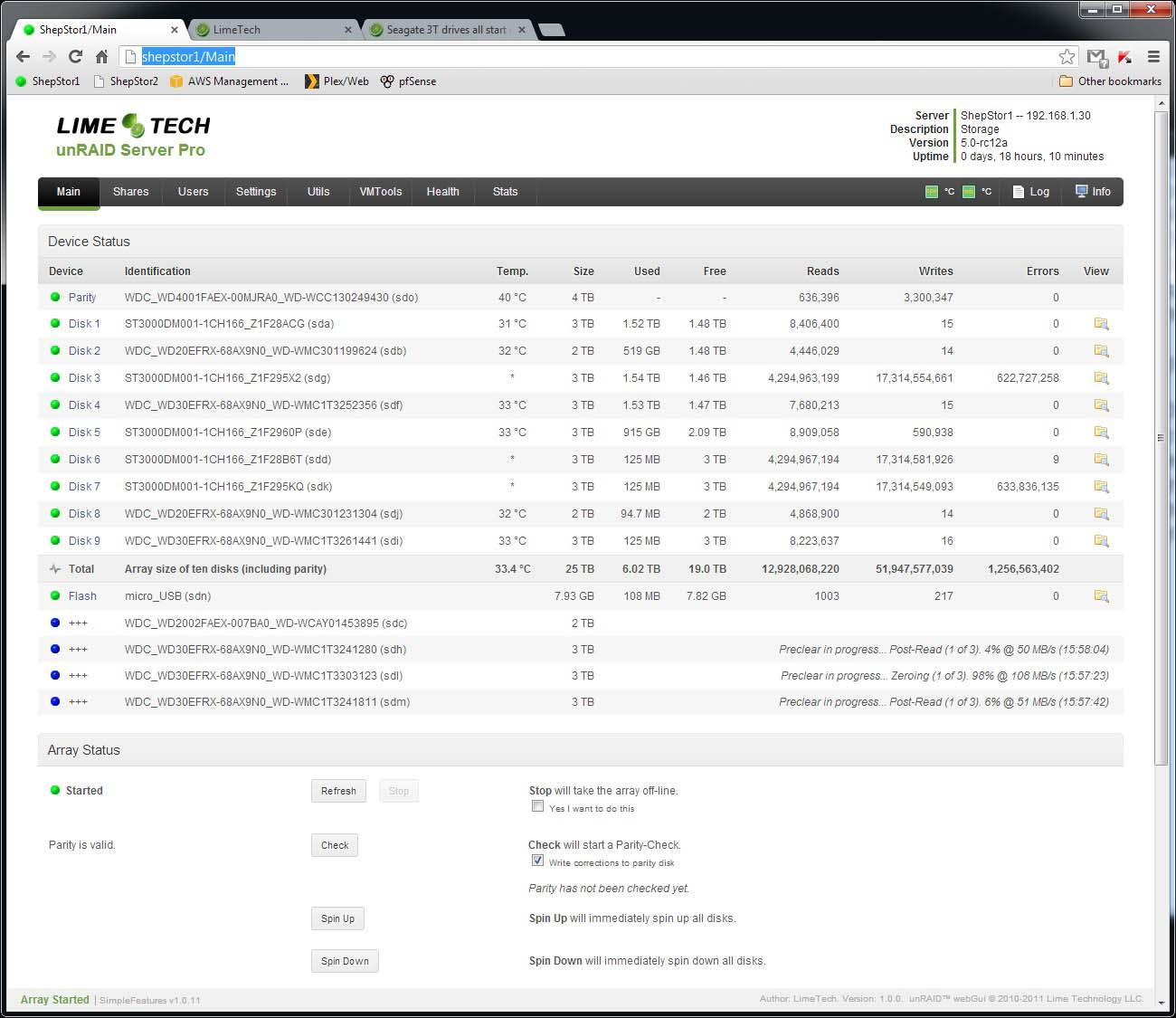

Post a picture of the main screen from the Web GUI.
Also, is there anything different between the way you're connecting the WD Reds and the Seagate drives?  [e.g. a different SATA controller card;  a port extender; etc.]
The picture will answer this, but what's the mix and assignment of the drives?

Picture attached.
I am running all the drives on the same RES2SV240 SAS off the same IBM M1015.
I did a 24 hour memory burn prior to the build. Note that unraid is running inside a 4G VM on ESXI.
All the disks passed a 3 count preclear.
By the way, ignore the throughput numbers on the 3 preclears at the bottom, I just checked and they are all running above 100MB/s.
Nothing "jumps out" here.  I really anticipated that you'd say the drives were on a different controller, or some such.  I can think of no reason the Seagates would all have errors on the SAME sector !!    Were these drives all purchased together?
