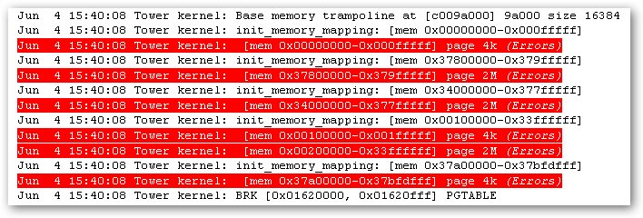

I loaded RC13, rebooted.
Getting some mem errors during the first stages of boot in the syslog. Anyone else getting them?  Only went from RC12 to RC13.
Tower kernel:  [mem 0x00000000-0x000fffff] page 4k (Errors)
sys log attached.
That is not an error, it is just a syslog line with the word "kernel" within it.
sys log attached.
Thanks Joe L.  That's good to know, but it does get highlighted in red and has the word (Errors) after it in unmenu so I was a bit worried.  The syslog doesn't mention errors, so I've learned my lesson to read the syslog before panic sets in! :)  I'll re-load RC13 and give it another go.

So the memory errors that is only seen from this release can be ignored?
Why are they visible / present now?
Duppie
They are NOT errors.  They are just matching a pattern in unMENU that used to only match on a different message that was an error.  I'll update unMENU so it does not highlight those lines.  You should be able to use its Check-for-Updates feature later today to update your version of unMENU.
Again, those are NOT errors.  They are only lines describing how your memory is being allocated.
