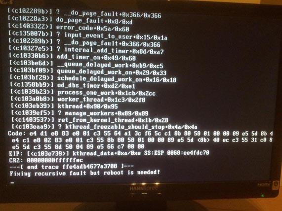

Similar problem as  hawihoney - When issuing  a stop command the array just hangs and the web interface locks up.
syslog attached
syslog2 - from telnet as the stop command was issued
screen.jpg - photo from attached monitor
I don't believe that I have any plugins on the system.
All was fine on 5-0 beta 12a
syslog.txt
syslog2.txt
and the screen capture
syslog attached
Syslog shows that there was an unclean shutdown previously, with the added issue that the flash drive file system appears to be corrupt.  Take it to another machine where you can run Check Disk on it.  As others have said, it is best to have a clean shut down, before upgrading.
If you upgraded the files on the flash drive on a different machine, you may have pulled it before the file system was completely closed.  Always make sure it is safe by using the appropriate 'Safe to remove device' tool.
