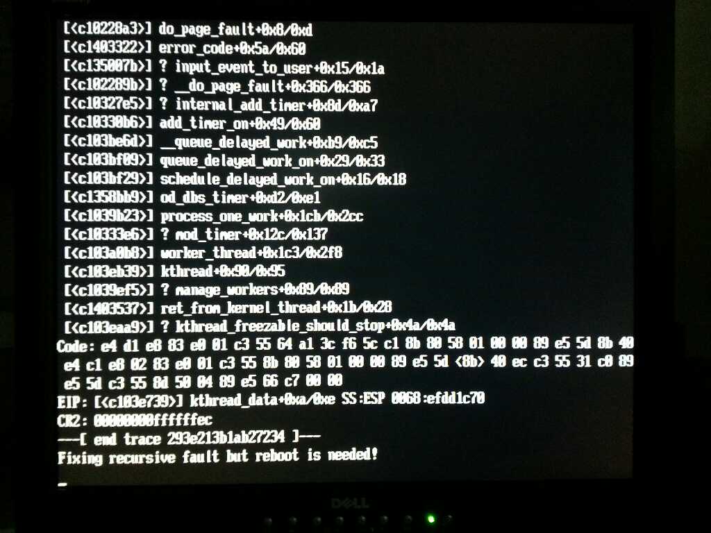

Hi
I had this is issue also with one of my servers which normally goes down every night with a /sbin/powerdown command in a cron job
last 3 nights he releases the array but never shuts down
so this evening i put a monitor on the server and caught this picture
have been looking this up and there seems to be some bug in this kernel 3.9 which seems related
https://bugs.launchpad.net/ubuntu/+source/linux/+bug/1178720
this is from ubuntu...
not sure if this is the issue with our unraids but thought i would add it... not a linux guru here ... just proficient with google searching

I now have had my second crash/hang AND this time around I had Barzija's keeplog going at the time of the crash. So it's attached. After the reboot I got another keeplog session going and then got unRAID into maintenance mode after stopping the parity check and successfully stopping the array. I'm running Reiserfsck on both my drives. I have a picture of the screen dump I'll put in an accompanying post.
I hope this helps!
syslog_2013-06-09_07.48.21.txt
I hope this helps!
Here's the picture..........

I wonder if those having this issue have something common at the hardware level?
That screen shot seems to correspond to what I see on the console of my system when the problem occurs.
