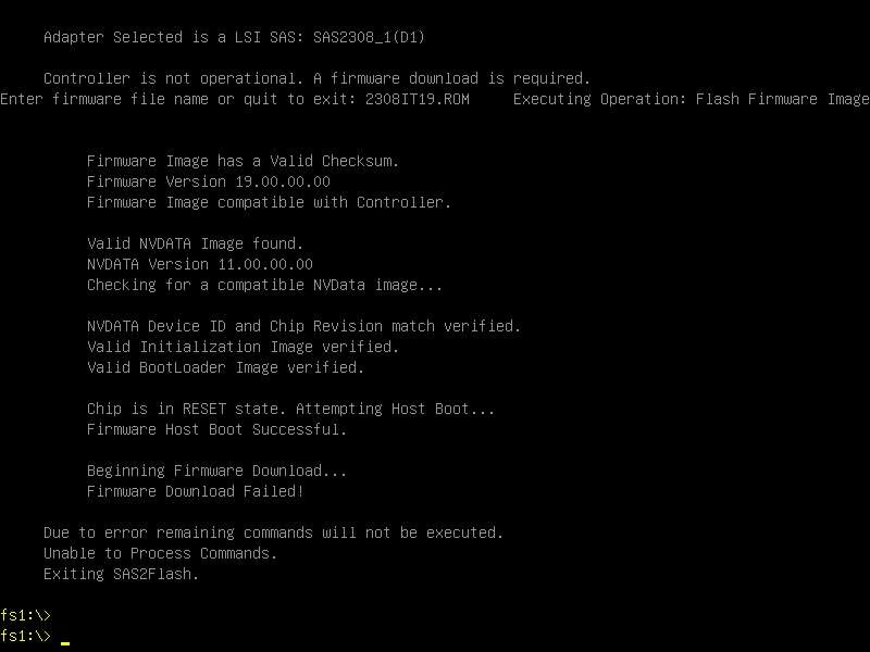

I have a SuperMicro X10SL7-F with an onboard LSI 2308 that I can't get operational. I think it may have been defective since I purchased board over 12 months ago, but I just attempted to expand array and can't seem to get any of the onboard ports for this controller to work.
I've been at it off and on for a couple weeks and I think I've been doing everything correctly. I've followed all instructions to flash it w/ the v19 firmware into IT mode but this is the error I keep getting.
Any thoughts would be appreciated.
Random long shot: there's an onboard jumper, not far from the RAM slots, called JPS1. Can you verify that it's enabled (closed) and properly seated?
Try the uefi version of the LSI flashing util.  I had issues flashing my LSI card until I used that.
Kind of bizarre, but I just repeated the steps exactly today and got the same error 3 times BUT it appears to have worked and the SATA slots the 2308 controls appear to be working. I never got anything but "failed download", but when I gave up and started the array the controller initialized and the drives were recognized.
I did update the MB BIOS yesterday, so there may have been something with that, but it doesn't make sense to me.
Not putting any array storage on these slots yet until I trust the stability of these slots.

ftp://ftp.supermicro.com/Driver/SAS/LSI/2308/Firmware/ - place to get IT firmware
Unplug all media/usb/hdds before attempting
Make sure to get LSI controller address:
put on blank USB drive (contents of UEFI folder)
push F11 on boot
boot from built in UEFI
change to USB fs0 - fs0:
check contents - dir
invoke script: SMC2308T.NSH
Input last nine digits of address when asked: enter last 8 numbers (does not have to be caps and does not include : colon)
remove USB once it says done
reboot and check in LSI controller utility that update applied and address correct - disabled boot option in lsi config util. based on this thread: https://lime-technology.com/forum/index.php?topic=12767.0
power down and plug all drives and unraid USB back in.
Boot and check everything in unraid
It recognized the disk on the controller and it's clearing it now. All in all, it seems good so far.
