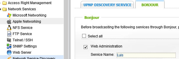

Other NAS manufacturers like QNAP allow controlling UPNP/Bonjour separately from shares. It could be something you can implement here also.

@limetech competing NAS products (like QNAP) also have the same issue. You can only give unique names to the different avahi/bonjour services, as you demonstrated. I don't think it is a big issue but giving the choice of naming from the webGUI might help.
