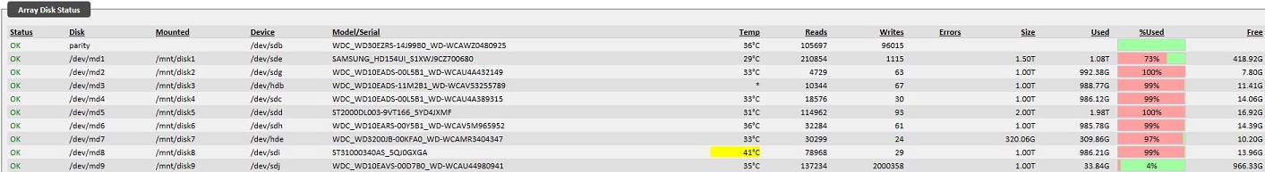

I am using RC12 with unmenu and have "unRAID Status Alert sent hourly by e-mail" installed. The emails report the system as being fine, however the syslog suggests that there are issues with the disc and I cannot get a SMART report for the drive. If I use http://Tower/Main the drive still has a green ball but reports 763 errors.
The drive in question was recently added to my array to replace a smaller drive. It was not brand new.
For now the array is accessible (I can read/write) and both web GUI's show the drives as Green, but the syslog errors and failure to produce a SMART report have me concerned of drive failure. I haven't rebooted the server yet.
I'm also concerned about the value of the email alerts - is this expected behaviour?

Can you show a screen-shot of the unRAID main page showing the errors?

You can have thousands of "read" errors, and a drive will not be taken out of service.  This is expected.  The drive WILL be taken out of service on a single "write" failure.    The linux kernel will often re-set the disk controller and retry and not even report the error upward to the calling process.
If all the indicators are green, then the disk is still being accessed.

disk1 seems to have lots of "media errors" (un-readable sectors)

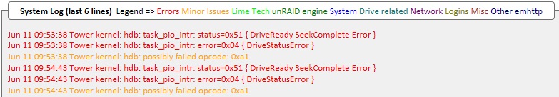

Another disk, /dev/hdb
seems to also have errors.  Is this an IDE drive? (not an SATA drive?) Is this the one not responding t the SMART report request?
Jun 10 17:47:02 Tower kernel: hdb: task_pio_intr: status=0x51 { DriveReady SeekComplete Error }
Jun 10 17:47:02 Tower kernel: hdb: task_pio_intr: error=0x04 { DriveStatusError }
Jun 10 17:47:02 Tower kernel: hdb: possibly failed opcode: 0xa1
Edit: It seems to be a WD-EADS drive according to your screen shot earlier.  If so, it is an SATA drive and you have the disk controller set in IDE emulation mode.  You need to set it in your BIOS to ACHI mode.  (Take it out of legacy mode, or whatever they cal it in your BIOS) Right now it is running in a much slower mode designed to emulate IDE disks so it can boot Win-XP or prior.

So it looks like this drive is about to fail, and a second (/dev/hdb) is also having issues... If so, why does unraid continue to report the array as being "ok"? If both were to fail it would surely result in data loss.
/dev/hdb is on a PCI-x controller. It's a generic card I bought on ebay running a Jmicron chip (BIOS v1.06.54), and its interface only has options for configuring RAID - nowhere to set AHCI. Curiously, /dev/sdj is also on the same controller, and I presume that because it's sdj it means it's been detected as SATA/AHCI. Strange that the other has not.
