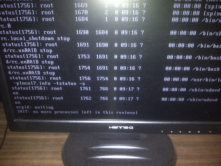

v6 is where I am having the problem.
The attached picture shows where it stops.
Hmm... the multiple calls to rc.unraid stop seem to indicate that it is not part of the rcdstock file. Could you check and add it if it is missing?
It is not missing.  I added some other files in the stock configuration.  Here is what I have.

I'd be happy to do some more troubleshooting if you have any suggestions.
rc.unRAID is the part of the powerdown package. I initially wrote it.
There is a slight bug in that it calls itself a second time. I was working with someone for repairs and he said he did not have time to assist.
I became busy myself. I could post a diff if interested. I was hoping to open it up more on google code and/or github.

Ok, I had a go at it and have fixed the following:
- Multiple executions of "rc.unRAID stop".
- Hang ups when shutting down.
- Cleaned up some minor warnings that could be a concern to inexperienced users.
I would like anyone willing to beta test this for me to give it a try.  I have tested it on unRAID v5 and v6.  My test server is a very minimal system with only a few plugins.  Both work as expected.
The issue of the lock ups depended on how clean the plugins shut themselves down on shutdown.  Basically the rc.unRAID was trying to shut down active pids on the array when there potentially weren't any to shut down.  When plugins were not shutting themselves down properly, they were active on the array and the routine to shut them down would succeed.  I believe this is why some had issues and others had no problems at all.
Once I get feedback that the powerdown is working properly in all versions of unRAID, I will commit it to WeeboTech's Google Code repository.  WeeboTech has graciously allowed me ownership privileges so I can upload my modifications.
Let me know that is working for you so I can feel confident that I'm not going to cause anyone any issues when it goes "live".
