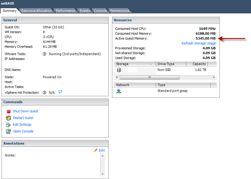

Madburg, may I ask you for a favor please? I see from your screenshots that you've allocated more than 4GB memory to that machine. Would you mind, when you have a chance, start that machine with less than 4GB, and see if you'll have any performance differences? And I don't mean just parity sync, I mean actual copying of large amounts of files (and big ones) to the server. Thanks.
I could, once I am done with all my tests. Parity won't be complete until tomorrow and I wont have a chance until after work, plus all the prep work for fathers day coming up :)
If you provide some details on what you consider large file copies and from a client to where? cache or array, create a scenario and I will do it when I have a moment.
How much memory do you want me to allocate, and under which boot option do I boot from with your choosen memory.
Whenever you have a chance.  From the hypervisor, allocate about 3.9GB memory to the VM and start it, without other changes. Boot unRaid normally, NO "mem=" options and such.
What I can tell you is once I fire up all my clients and workload aginst the unRaid server and kick off the mover my mem utilization hits above 5gb. So there is no way in hell I would settle/live with a non pae build on a permanent bases.
Oh, no, that's not  5GB used really, that contains all discardable cached buffers. That's just how the linux kernel works: if you have 100GB physical ram in your machine, you'll see it is using 100GB. I can bet my old running shoes that your server will do exactly that same load with 2GB memory allocated to it. You'll be surprised.
Ok I will test with 3gb of memory
I don't believe it's not using the 5gb when it's taxed. U say it uses everything u give it, but I never seen it take all 6gb in total. During this parity check for example its using 1.5+- not 6GB and not 5GB. Call it buffers/flushes whatever, if there's no memory for it, performance suffers. I withness it first hand plenty of time messing around with unRaid for these two years. There is no ballooning as when u pass through a device, in my case a controller to the VM it forces the allocation of all that memory to that guest And reserved from the host from ballooning/over commitment from any other guest. VMware warns you of this. As their goal is to not have any dependence so one can utilize vmotion, HA/DRS etc. once you subject passing through a physical device to a guest, all that technology and flexability is gone. Which in our case is perfectly fine. We are committing a chuck of our physical hardware to unRaid and the rest to be utilized for other virtualization aspects. This way another chassis, psu, proc, etc. is not required to be purchased.
Esxi makes it very easy to see utilization, especially when the host is being managed under vsphere where it stores historical data. So you can look back And see what happened at 3am when the mover kicked off, how long and what resources (CPU cycles, memory) were being utilized. Versus not knowing much about Linux, unRAID and making guesses based on a few glances at what some plugin or command may show at a point it time when you ran it.
Oh, it's using it, but not in the sense how Windows apps are using memory. Give Linux 200GB memory, and then start reading/copying lots of files around, and you'll see it "using" all that memory. It caches about everything it can possibly cache. And that's a good thing. But all those buffers are immediately discardable when needed. So don't let it give you the false impression that it's struggling for memory.

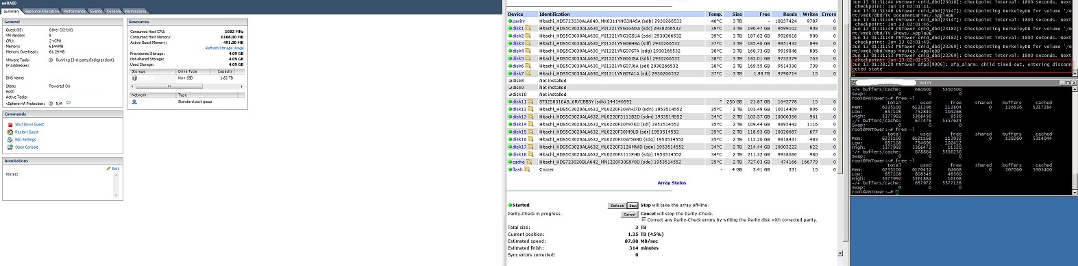

Parity check at 45% (more than 1/2 way through the 2TB drives now):
Observation, went up stairs to watch a show via mac mini (plex), now that the parity check is running, cannot connect to unRAID via AFP, syslog shows constant disconnects. Initially tested when I first brought up RC14 and before running a parity check, I was able to connect no problem. Tested with a second AFP client same thing, screenshot shows the syslog tail with afp disconnect logged.
250GB drive spun down, ISO finished being extracted, so cache spun down as well. ESXi showing mem utilization dropped (i bet right after the iso completed being extracted) don't know if drives spun down would elevate any memory on unRaid as well...
Change in Low mem though,  the lowest i have seen so far during this parity check 48560 (also in the screenshot) to tired, I thought I saw 4856.. (its 48560) going to bed. A bit low, but not that low. Just checked again its 80388

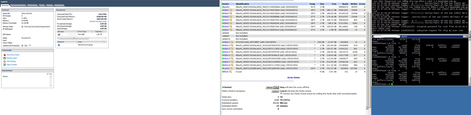

Parity check at 99%
I Forgot, I have backups that start at 11pm getting written to the unRAID cache drive. I had several movies, tv shows and backups scheduled to be moved to the array at the default mover schedule, (which are all still moving, do to the parity check running) so this parity check will not be my best time but a good exercise for RC14.

Here is a screenshot, once parity check finished, mover was free to do its job at 100%
unRAID utilization: (not 6GB, but 5 and change Barzija)
Parity check at 99%
Well of course. Is there any contradiction with what we talked earlier?
Give it 20 and it will fill up 20. (Or 19 and change.)
Nope, just had the opportunity to show you (capture) specifics, thats all.
