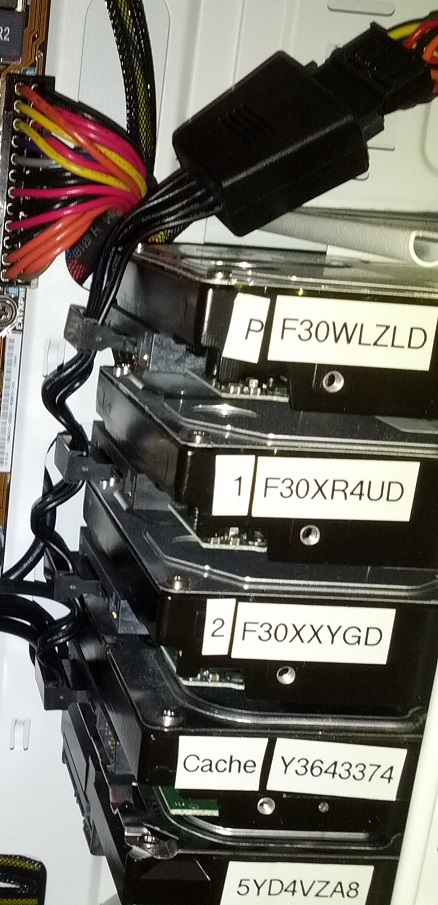

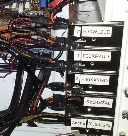

Before
After.  Note that my drives are closer together than planned for the connector.  so it took some work to make the short wires bend to fit.  i had to do the same thing with the PSU lead as you can see, but that was easier because they were longer.  of course that also made it less clean [shrug].
in the end, i think when it comes time for me to add another (with 4 more drives), i might not because the large head connector will be right in the middle of all the drives, and since most PSU leads have multiple connectors, a few unused ones that are connected to the second 4-in-1 will be sitting around making it a mess.  though some creative cable management around the "back" of the case might make it neater.
Still looks a good bit neater than in the "Before".    I suppose they need to allow a bit of slack to ensure the connectors work with various cases with slightly different drive spacing (although I'd think that was pretty standard).
Yeah it does, but notice i don't have the sata cables in place in the after.  My main worry is they put stress on the drive's power connector.  again, i had the same concern with the PSU line, but it was easier to force them to conform.  But so far so good and you're right, it does still look a little better.  For whatever that is really worth :o
