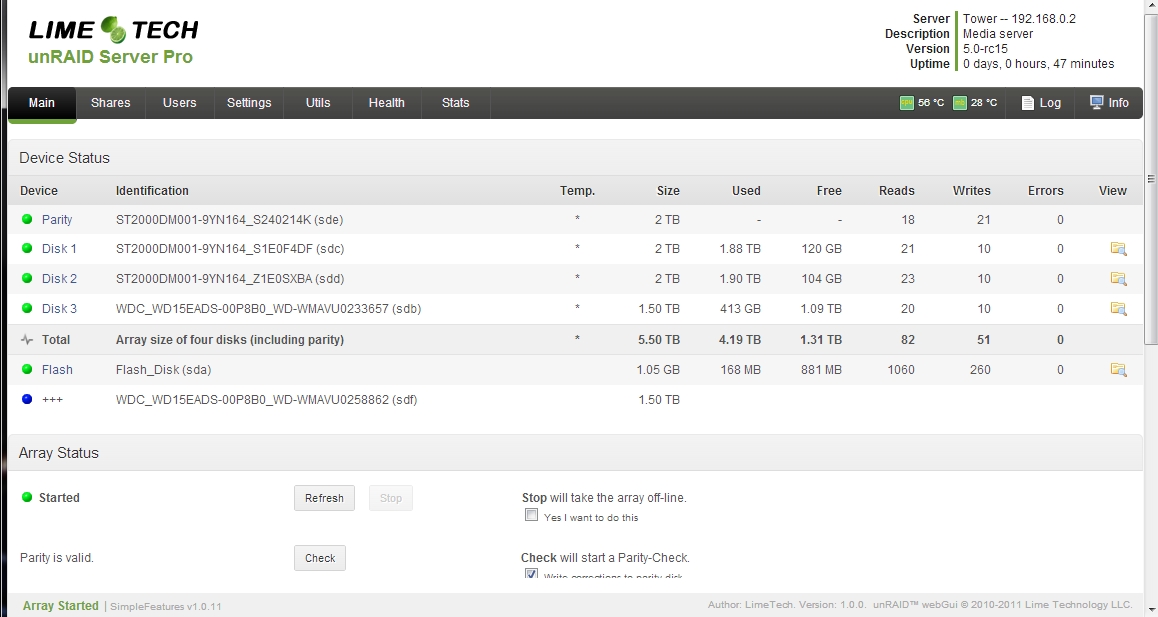

Im not really sure what happened after i upgraded to rc12. Ive always had simplefeatures installed with the sleep plugin and ive never had an issue with my array going to sleep x amount of time after the drives spin down. Now when I turn on sleep and set it to sleep 15mins after drive inactivity the server never sleeps. Does anybody else have ths issue or know why the sleep function stopper working?
I can use sleep from the simpleFeatures main menu and it puts my server to sleep so i know that sleep does work.

Ive upgraded to the latest rc15. Within simpleFeatures it says ive got "s3_sleep version: 2.1.0" and I have
- 'Wait for array inactivity' to 'Yes'
- 'Extra delay after array inactivity' to '1'.
- 'Wait for network inactivity' to 'No'
- 'Wait for user login inactivity' to 'No'
I manually spin down the drives and wait but the server wont shutdown. Doing it this way to test sleep used to work everytime but for some reason since rc12 its stopped working. I can manually put the server to sleep and it goes to sleep/wakes up perfectly - not sure why Unraid wont send the sleep command?
I tried changing the spin down times in the actual disk, then also changing them back to 'use default' which is 15 mins - but that shouldnt matter since when I refresh the page even after 20 mins its showing the drives as asleep.
Also does it matter if I have a drive attached thats not in the array? I am using that as a backup?

I think i've solved this issue, though it raises another one.
I had an extra drive in the system that was attached & precleared but not part of the array. I figured maybe it was that disk that was making activity on the system. I removed that 'hot spare' and then voila the simplefeature sleep script worked perfectly....now all I have to figure out is how to wake the system back up :)
Does anybody know what that extra drive was showing activity? I thought since its outside of the array it would never really be spun up.
The s3_sleep script will check drives outside the array for disc activity. If a preclear was running, it wouldn't be nice if the sever went to sleep. If no process is accessing the drive it should spin down and the script should sleep the server.
If the drive doesn't spin down for whatever reason, the system would'nt sleep. Or if the drive reports a state the script doesn't recognize as  spun down, the system would'nt sleep either.
I have a ssd that always reports active and therefore prevents sleep when installed.
