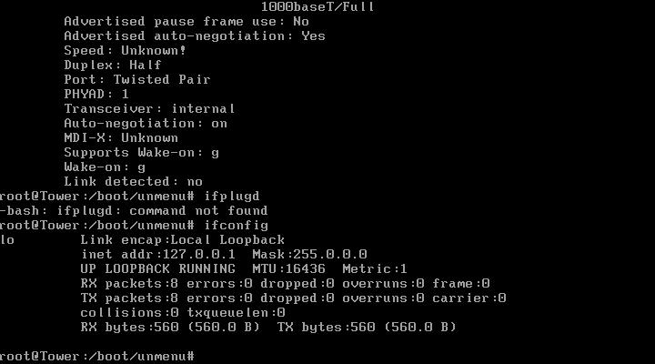

With 5.0 RC8a the network controller does not appear to work correctly.  When I type ifconfig at the console eth0 does not show up.  Using ethtool I am able to see the eth0, and eth1 interface, but neither have an IP.  When I downgrade back to 4.7, the network interface works without issue.

"ethtool eth0 ouput"

Problem is missing firmware for your NIC:  bnx2-mips-06-6.2.3.fw
Apparently this is a known issue in the linux kernel, don't know why no one has ever fixed it.  I'll include in next release.  In meantime you can try this:
