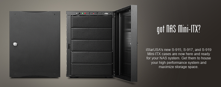

June 15, 201313 yr Anyone see this? There's very limited information other than dimensions of the different models here. I can't find any internal pics or any reviews, or even a place to source one yet. But the loss of that 5th or 6th drive in the new Gen 8 HP Microservers has made me want to look for an alternative. The S-915 pictured above looks to be my ideal mini-server, although the S35 more closely matched the Microserver in dimensions (10.5 x 8.3 x 10.2 in vs 7.87 x 8.35 x 12.09in). With a 5-in-3 you can get that 5th drive back.
June 15, 201313 yr That's a Nice Case ! get one 5-in-3 plus one 3-in-2 and you're good for 8 drives with a M1015 in that little box. I also see there's a 7x 5.25 case and even one with 9x 5.25 ...too bad that the bigger ones are still mITX and not mATX.
June 15, 201313 yr Those are indeed nice cases => you could put 15 drives in the S-919 using 5-in-3 cages. However, my favorite "mini-server" case is still the Lian-Li PC-Q25B, which holds 7 drives, 5 of them in an internal hot-swap cage, and all with outstanding ventilation ... my drives in that system run notably cooler than those in my 5-in-3 cages in my larger system. As for mini-ITX being a problem ... this little Asus board has 6 SATA ports AND a PCIe v3 x16 slot: http://www.newegg.com/Product/Product.aspx?Item=N82E16813131841
June 15, 201313 yr ...too bad that the bigger ones are still mITX and not mATX. According to the specs at iStar's site, the S-919 WILL accommodate a MicroATX motherboard: http://www.istarusa.com/mini-ITX/nasspec.php (See the line towards the bottom of the chart labeled "Motherboard Size" It IS still marketed as a "mini-ITX NAS Tower" ... but assuming the specifications here are correct, you could use it with a larger motherboard.

June 15, 201313 yr According to the specs at iStar's site, the S-919 WILL accommodate a MicroATX motherboard: http://www.istarusa.com/mini-ITX/nasspec.php (See the line towards the bottom of the chart labeled "Motherboard Size" It IS still marketed as a "mini-ITX NAS Tower" ... but assuming the specifications here are correct, you could use it with a larger motherboard. ...cool, thanks for pointing that out...must have overlooked at first myself. I am a new fan of using AM3+ CPUs (AMD FX or Opteron 3300 series, as they support ECC memory and AES-NI instructions'). Things you will only find combined in XEONs on the intel side of life...and you will need a server chipset mobo with it, while almost all ASUS (and some Gigabyte models) AM3+ desktop boards support ECC. However, there are only mATX boards, no mITX (most likely because of the high TDP of the FX processors).

June 15, 201313 yr With the S-915, I could put 2x 3-in-2 cages, and then a 2-in-1 or 4-in-1 SSD cage. That would make a 1 parity + 5 data drive box, with a cache drive pool. With 4TB drives that's a 20TB box. That's the config I'm thinking. Regardless, I'm loving the fact that the OEM manufacturers are coming up with so many good options for home NAS solutions! Yes, exactly the same config what comes to my mind ...and I am still on the wrong side of the pond, as with the new case from limetech which is also build-to-order from iStarUSA. :'(

June 16, 201313 yr I'm using a Supermicro X7SPE-HF-525 Atom board and while it's advertised as a Flex-ATX board it's only ~2cm wider (with additional mounting holes) than a mini-ITX for which these cases are designed. I'm interested to see some interior pix to gauge whether or not my board might fit. This case series looks pretty good!

June 21, 201313 yr Based on the specs, there's actually another internal drive bay for a 2.5 drive in there. Can't see it from the pictures though. Can anybody help design the best budget build for this? Starting with the free license and maxing out with the plus license.

July 10, 201313 yr Amazon is now selling the S-35. Haven't found any info on the S-900's though. http://www.amazon.com/iStarUSA-S-35-Compact-5-25-Inch-mini-ITX/dp/B00DJ7T3YK
August 15, 201313 yr The S-900 series is now for sale online. They're available from Mwave (mwave.com or their ebay store) and Newegg. S-915 at Newegg: http://www.newegg.com/Product/Product.aspx?Item=N82E16811165596&nm_mc=OTC-RSS&cm_sp=OTC-RSS-_-Server%20Chassis-_-iStarUSA%20Inc.-_-N82E16811165596 S-915 at Mwave: http://www.mwave.com/mwave/SKUSearch.asp?scriteria=AA85235&pagetitle=iStarUSA%20S-915%20Compact%20Stylish%205x%205.25%20Bay%20mini-ITX%20Tow#.Ug1gwnYo6po
August 16, 201313 yr I'll echo the thanks for posting the update. This is a nice looking case for systems that require an externally accessible 5.25" drive (e.g. an optical drive) ... but for an all-storage setup I'd still favor the Lian-Li PC-Q25B, which has 5 hot-swap bays plus a bottom tray that holds 2 more drives (or 3 2.5" drive). I've built 4 systems with that case, and it's really "perfect" for an UnRAID "Plus" system.
