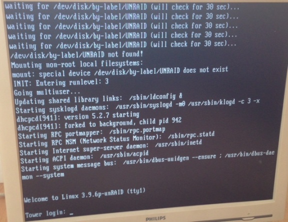

Hi there,
sometimes I get those weird messages on the screen about unraid not finding the actual USB key it booted from. The only thing to to is to "powerdown" and turn it on again.
The USB is labeled UNRAID, this happens maybe 1 out of 5 times.

I've seen several older small (128MB, 256MB) flash drives that have this problem a lot.
If that's not your issue, you could have a marginal USB port ... but I think it's far more likely it's the flash drive.
If you're running the free version of UnRAID, put it on another flash drive -- preferably a new, high-quality unit like the Cruzer Micro or a Kingston Data Traveler.    I suspect that will resolve the problem.
If you're using a paid version, you need to contact Limetech and ask Tom to switch your key to a new flash drive.    Buy the flash drive first -- install the basic (free) version of UnRAID, and boot to it, so you can capture the GUID, which Tom will need to issue a key.    Or just buy a pre-configured key from LimeTech.

The USB Port is on a PCI USB 2 controller card since the computer only has USB 1.
I just bought the drive 3 months ago, its a "4 GB Transcend JetFlash 300 black USB 2.0". Do you realy think a brand new USB drive fails that often?
This may be an issue with your add-in card.  Does it boot okay (obviously SLOWLY) on the built-in USB ports on the PC?

I'm not an expert at reading Linux syslogs, but I glanced through it and don't see anything that indicates a problem.
I'd try booting directly from the onboard USB ports ... if that works consistently, then you could just use that => except for the very slow boots, it shouldn't have any impact on the normal functioning of the array, as there's very little interaction with the flash drive while UnRAID is running.
