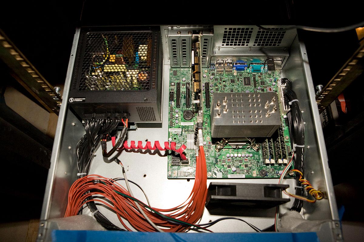

Found this image on a search... are you able to push the cooler slightly off center as shown in the attached image?
Or is it possible you're pointing the heatsink up and down (fan would blow either up towards the top of the case or down to the bottom) instead of the traditional left to right?
Sorry, yes, I probably should have mentioned that. I have it blowing air towards the "top" of the case (towards the side with the PSU in a Norco 4224) and then use a piece of plastic to guide the air towards the PSU so it gets sucked out of the PSU/rear exhaust fans and doesn't get recirculated back in to the case. Unfortunately I don't have a picture.
