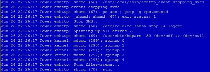

My syslog is below. As you can see it has reached the sync command and not gone on to trying to unmount the disks.

I've seen 'sync' hang plenty of times during development.  In each case I just wait "a while" (a few min) and reset.  The server comes back up with a parity-check started.  Most of the time it shows zero parity-sync errors so I just cancel it.
