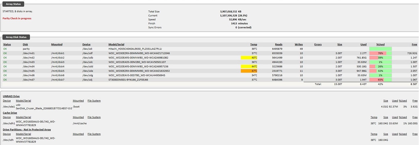

July 8, 201313 yr Author unmenu screenshot attached Cannot seem to run reiserfsck at the moment due to the parity check running.
July 8, 201313 yr The syslog and the screenshot indicate that the server is working correctly. What is the issue?
