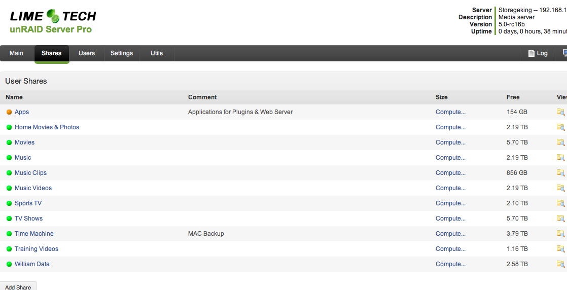

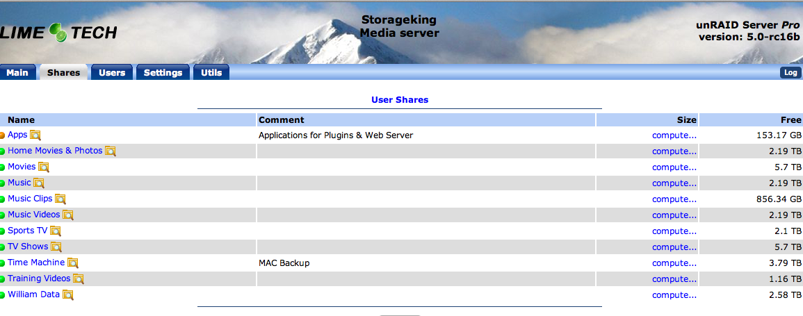

Does anyone's user shares report different free space?
All my shares bar 2 should show the same amount of free space,
Time Machine is setup to use Disk8 only and Apps is setup to be Cache only
These are the free space reading (in simplefeautes)
Home Movies 2.9TB
Movies 5.7TB
Music 2.19TB
Those are setup to use All Disks for the shares.
Replicated on standard install without simplefeatures.
BillyJ, disable simplefeatures and check the problem exists in the stock share report.  Otherwise it's just another simple features issue as the RCs progress.

Disk assignments are all set to All, except Time Machine is just set to disk 8. Thats a 3tb drive which is registering 3.94TB free?

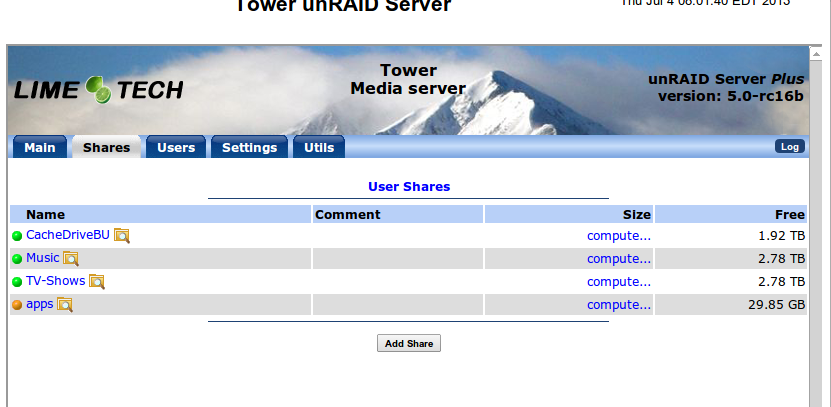

I updated from rc15a to 16b without issues. However I also show a difference in my share's free space. Picture attached below. I want to say it was like that in earlier releases, but I'm not really sure and at the moment I don't want to regress.
The differences between the CacheDriveBU share and the others is that it does not use the cache drive  and no split levels.

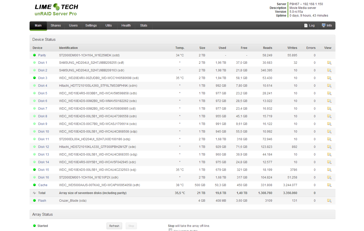

Free space now seems to be calculated as dlandon says.
the Share 'Movies' is on disk 1 (100gb free) , 3 (300gb free) & 4 (50gb free) Total that unraid displays free is 450gb not the combination of free space on disks 1 to 4. This is irrespective of the included or excluded disks.
