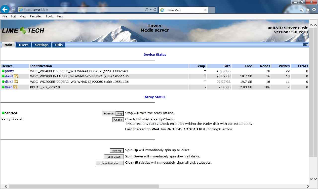

Perhaps you had installed Simple Features (I don't know exactly what it shows, as I don't use it) ... but in any event, the main UnRAID GUI does NOT show those columns ... and I'm fairly sure never has.  It's certainly not on my v4.7 system nor on my RC16c system => and I don't recall it being on any of the earlier v5 Betas or RC's, although I didn't install all of them, so I can't say for sure.
I did, however, just to confirm, install RC10 (the version you referenced) on a small test system I have to be sure that specific version didn't have those columns ... and here's a screen shot of the main Web GUI:
Thanks, I must have installed Simple Features a while ago and forgot about it.  I'll play with it this evening and be sure.
