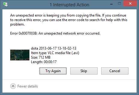

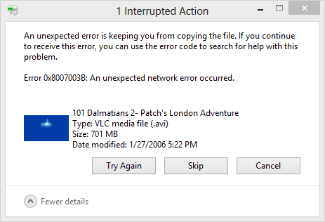

Eventually i get this error:

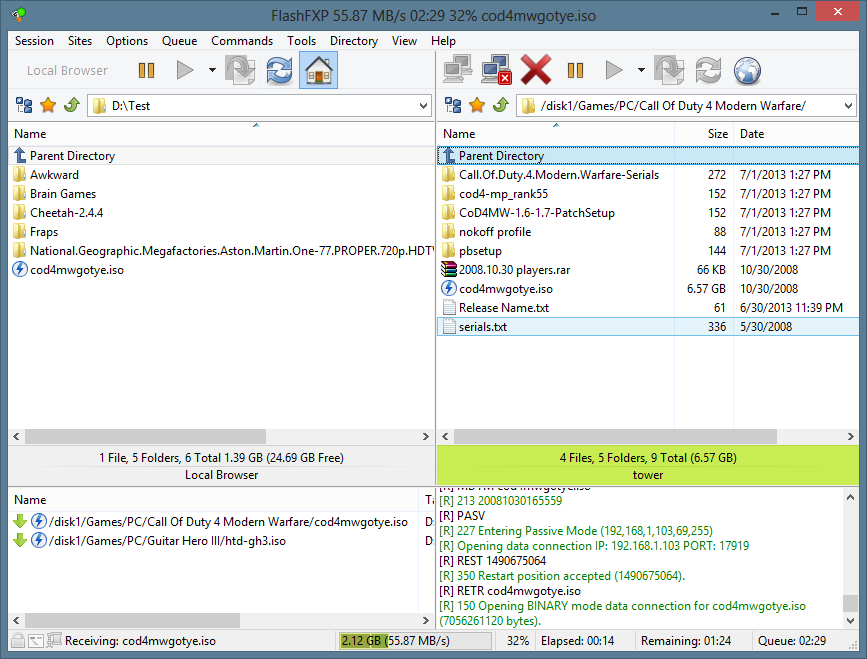

I can confirm that the problem lies in accessing the Tower over SMB share.
To test I connected via FTP to do a transfer and got much greater speeds.
See Screenshots: (FlashFXP used for FTP)

Read is just as bad as write. Here is copying a ISO file from the unraid server to my pc over network. The problem lies in the windows shares I'm sure of it, if I use midnight commander to copy between the drives on my server the transfer speeds are 60-70mb/s.

The Unexpected network error message was using windows 8 file copy (maybe appears differently due to Classic Shell Application). So was * SMB slow.PNG using windows file copy.
The ftp application used was flashfxp. I couldn't connect via ftp in 5RC15, but after downgrading to 4.7 I was able to ftp in with username root, pass blank. That 55mb/s is reading from the unraid hey, not writing.
