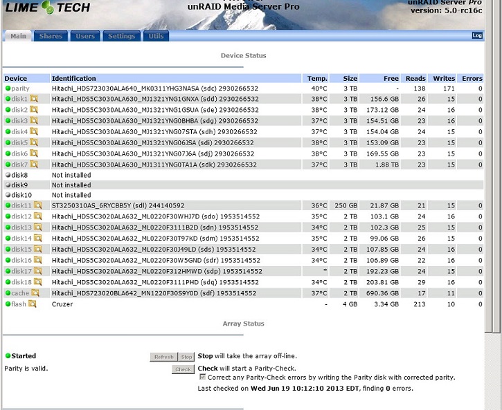

BTW, keep forgetting to bring this up, I used to have a disk8,9,10 a while back, once I removed them and cleared the config, I get entries "Not installed" in the webgui for the drive assignments where those drives used to be, this used to not happen back in the days when one cleared the drive configuration. You would not get "Not installed" entries in the WebGui.
So if one starts with a completely fresh unRAID installation and leaves gaps between drive assignments it is not reflected in the WebGui, if you then clear the config and remove any drives and start the array THEN you see the "Not installed" entry(s). Should not be the case right?
Screenshot displaying behaviour attached.

I tested the behavior on a development rig.
I stopped the array, started a new config.
assigned drives 1-3. I put drive 4 in slot 5 and now slot 4 says "Not Installed".

I just stopped my array, did a new config.
reassigned drives 1-3, put drive 4 in slot 23.
All slots in between said not installed.
I then did a new config again.
Put drives in slots 1-4, there are no not installed slots.
I think it prunes the list at the end of last installed drive, but for drives in between first and last, it says "not installed".

Starting from a fresh boot with no super.dat.
Assign drive 1-3, 7  (parity, disk1, disk2, disk 3in slot disk7).
slots 3,4,5,6 show "Not installed".
There aren't any not installed slots after slot 7 and before the flash.
