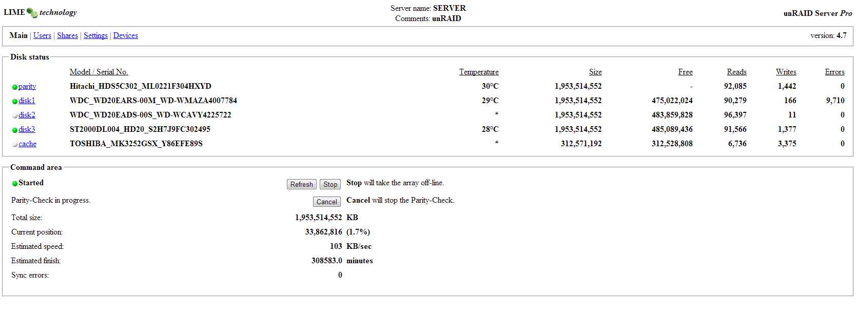

This is my first time I had problems with a parity check it just keeps increasing in errors on a disk.... and it's going really slow on parity.... please help what should I do next? BTW I just switched everything to a new case. Disk 1 works perfect when I get in it.  ???
Here is a pic....  :o and the log. Thank you.

Post a SMART report for disk1.
Here you go.... thanx.
sdb_disk_1.txt
So do a short smart test or a long test? From what you see what do you think is wrong? I am going to turn it off and replace the sata cable before I do it.
I'd replace the drive with a spare and then run pre-clear on the current drive. If the current_pending_sector RAW_VALUE goes to zero the the drive will become the spare. Or you can re-enable the drive and rebuild on to itself. The current_pending_sector RAW_VALUE must go to zero or the drive must be replaced.
