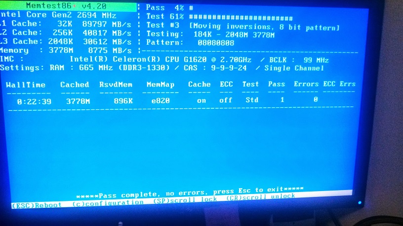

Also - curious here. Memtest shows "Single-channel" under settings (see attached image). Shouldn't it be dual-channel? I have 2 sticks of 2GB each. Is this something I have to set in BIOS?
Normally not, but it wouldn't hurt to "look around" in the BIOS and see if it is indeed a parameter you can change.  I believe you bought a board with only 2 memory slots ... but if not, you probably have the modules installed in the wrong two slots [if you have 4 slots, you typically have to use slots 1 & 3 to put the modules in different channels - but that's not always the case, so check your manual].  It's also possible that MemTest86+ simply doesn't "know" about your chipset and is miss-representing the configuration.    The latest version (4.20) is a couple years old and may need an update.
MemTest86+ works fine with Ivy Bridge => just realized I have a nice new Core i3-3225 system in the back room I'm setting up for someone else, so I booted an UnRAID flash drive on it and ran MemTest ... and it shows dual channel just fine.
So check your BIOS to be sure you don't have memory set to single channel -- or if you bought a board with 4 slots, move the 2nd module to the other channel.
