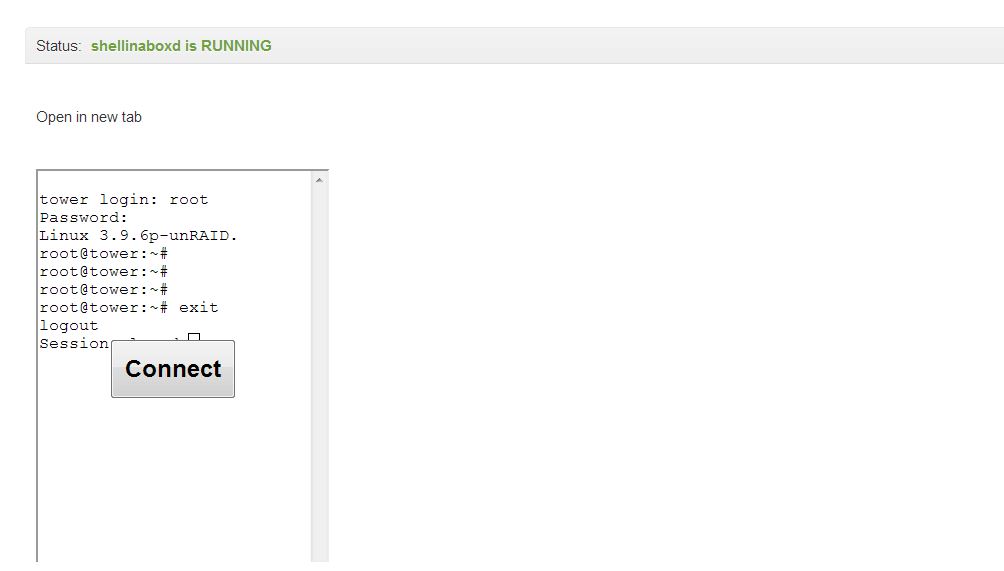

Now it works, but there is only a small issue on the GUI....
//Peter
//Peter
Nope, only looks that way in SimpleFeatures.  I do not use Simple features and don't really care to try and figure it out there.

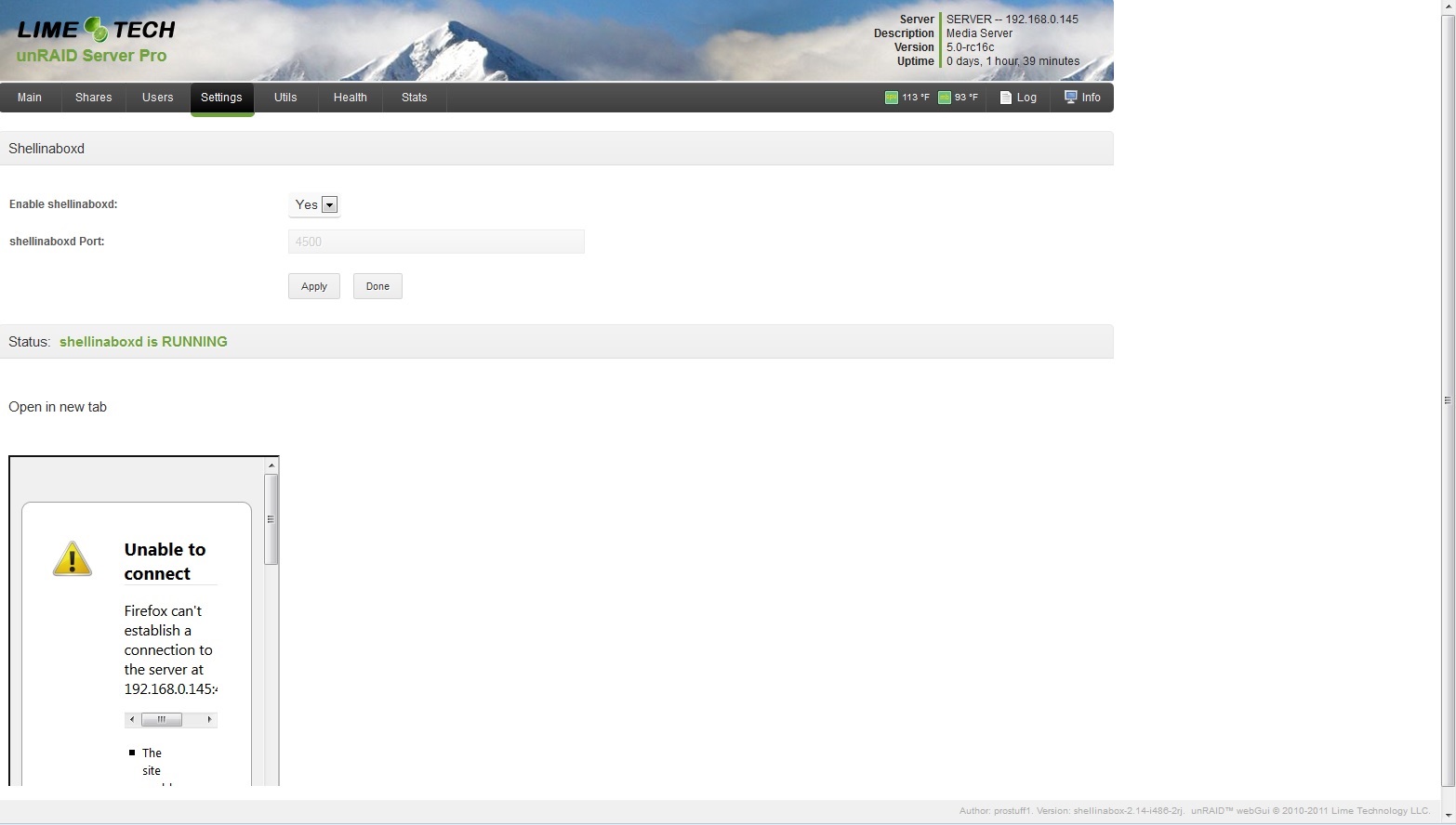

this still working with this new GUI?
installed it on both of my servers but only one has the new gui
and on the one with the new gui i get server refused connection
on the server with normal SF it works fine ....
nothing in the logs... it only says it is running ...
oh yeah it tried like 4 different ports ... all same effect
screenshot doesn't show the txt about server refused only shows when rolling over the little smiley

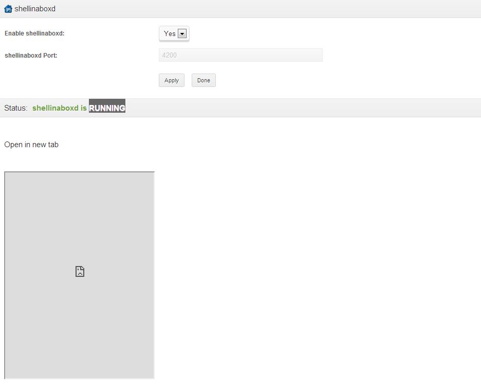

had original web gui plugin installed, but needed one that worked with FF and tried this one with no joy. The service starts but cannot connect no matter what port i switched to... any help would be appreciated

Are you running 5.0rc16c on the new box that you installed the new GUI on?
If you hit open in new tab, does it work?
See my above post
tried to open in new tab. does not work tried changing ports and tried again, but no joy...
