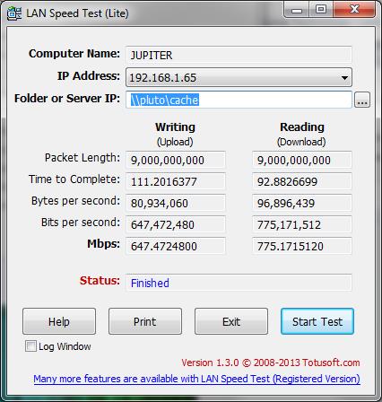

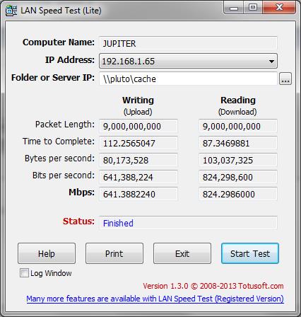

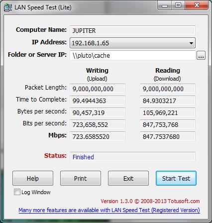

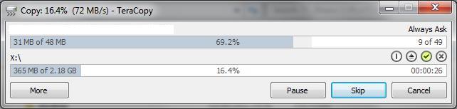

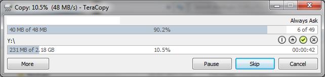

July 27, 201313 yr Author After much trial and error I think I may have solved my issue. It looks like it was the 5 port 10/100/1000 Netgear GS605v3 Switch, I pulled the power to it and reset it and then used Lan Speed Test to copy a 9GB test file to \\pluto\cache and it uploads at 80.173 MB/s and downloads at 103.037 MB/s. Teracopy uploads to the TV_Shows share at a constant 72MB/s (cache share) and to the protected array share at 24MB/s - 48MB/s sometimes a little slower but it builds back up to constant 48MB/s. First time I've know of a switch doing this but you learn something new everyday Got a new Netgear GS105 5-port Gigabit Ethernet Switch on route to replace the ageing GS605v3. http://www.amazon.co.uk/gp/product/B0000E5SEQ/ref=oh_details_o00_s00_i00?ie=UTF8&psc=1 Will report back once the new switch is here and see if it makes a difference.
