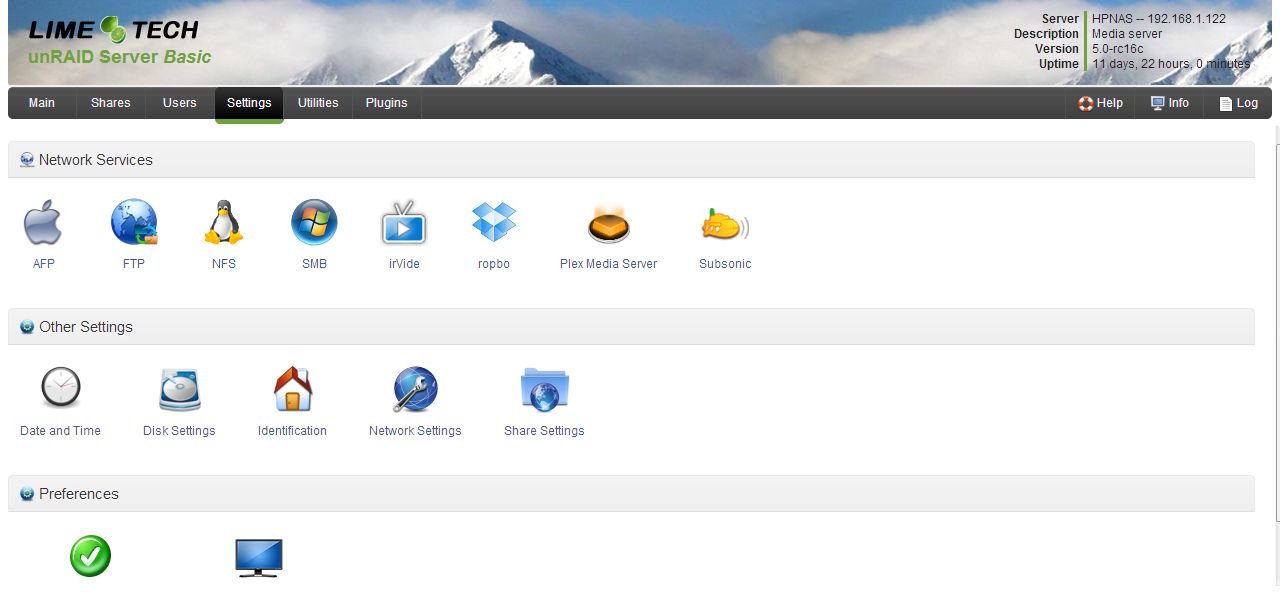

I just installed, but did not reboot.  Couple of things:
a) I also get the truncated names in Settings.
b) Why do plugins for Airvideo, Dropbox, Plex and Subsonic under Network Services in the Settings page as well as the Plugins page.
c) Plex appears on the Plugins page as "No plg file", but Airvideo, Dropbox and Subsonic appear as "installed".
d) I also have SABnzb installed - this appears on the Plugins page but not on the Settings page.
e) I can't see how to access the webpages of the plugins on my unRAID from the Plugins page - I can access Airvideo, Dropbox, Plex and Subsonic from the Settings page, but I can't link to the SABnzbd page because it's not on Settings (however I know it's on http://hpnas:9090/).
The "Plugins" tab on the menu might be more properly labeled "Plugin Manager".  The idea is that installing a plugin can alter the functionality of the system in many ways.  For example, installing a single plugin could result in several pages (with corresponding page icons) showing up anywhere in the menu structure the webGui.  Also, one could design a plugin that doesn't add any user controls to the webGui at all but instead does something to the underlying system instead, for example, maybe it install a different 'mover' script, or replaces some other component that doesn't have a UI.
We will be adding more controls to the Plugin page in the future such as a button that says "hide all uninstalled plugins".  We will probably add more organization to the table, perhaps introducing separate tables for each category since the list is likely to become rather long.

Regarding truncated plugin names, I figured out that by wrapping everything in double quotes on the xxxx.page fixes the problem.
eg. in the case of airvideo, the plugin creates file called airvideo.page with contents:
Menu="NetworkServices"
Icon="airvideo.png"
Version=1.2
Author=overbyrn
Type="php"
Title=AirVideo
I needed to wrap quotes around those that didn't have it.  Result being:
Icon="airvideo.png"
Version="1.2"
Author="overbyrn"
Type="php"
Title="AirVideo"
Guess that means I'll be updating my plugins  :P  Although will hold off until I know if there are any other changes necessary.
