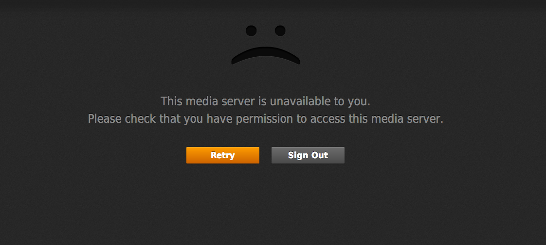

Thanks for the thread everyone.  I am hoping someone here can help with my issue.
I have followed the instructions posted here and have Plex Running.  However, when I access tower:32400/web and login to plex I get the following error.
This media server is unavailable to you.
Please check that you have permission to access this media server.
Any ideas?  I am open to suggestions.

Is your unraid/plex server on the same subnet as your pc?  do you have noscript disabled?  Cookies enabled?
Definitely on a different subnet.  So based on that comment, do you think I would need to edit the preferences.xml file and add the AllowedNetwork Attribute?  Seems fairly archaic.  I bypassed that problem as the posts I was reading seemed very old and figured that this issue was addressed in current Plex releases.
Not sure about the noscript disabled.  Haven't seen anything on that one in my forum travels.  Will look at what that means.
No Cookies.  Using incognito Chrome to ensure I didn't have any issues like this.
N noscript is a Firefox addon to block scripts.  the fact that you didn't know that tells me you aren't using it :)
Subnet: that is most likely the problem.  It isn't a bug that would be fixed in current plex.  For security they prevent other subnets from accessing plexweb.  How to fix it, no idea other than adjusting your subnets, but there might be a some info on the plex forums on how to whitelist a subnet.
No cookies?  umm you need cookies I think unless you're saying incognito will allow session cookies but won't retain any bad settings.

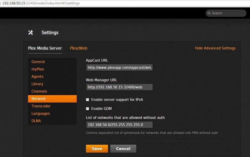

No you still have to allow other networks. But you don't need to edit any file. Click on the settings and choose advance and under network you will see allowed networks and add that subnet and voila you will have access.

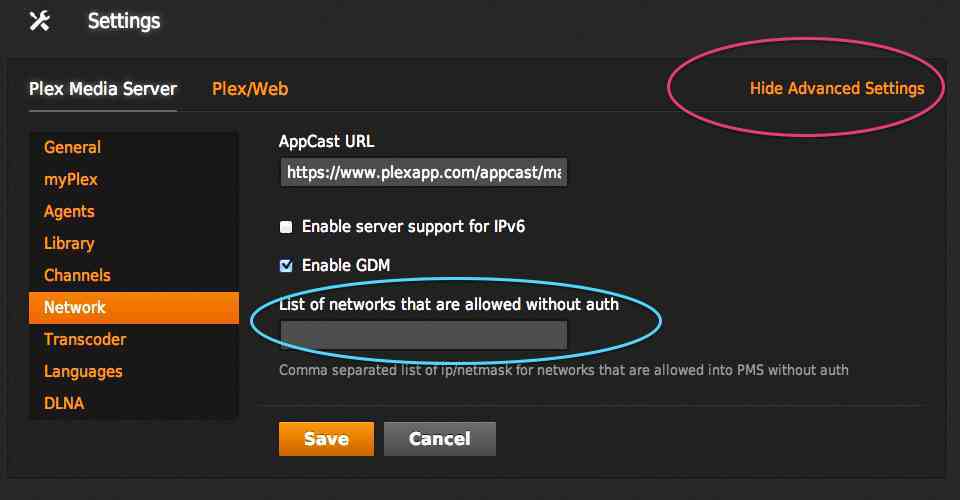

I don't have an advance option under settings for my plex install. All I have is just the directory fields.  Where are you referencing the advanced option.
Plex Advanced Settings...Click on the crossed tools icon for settings, then its in the upper right.
This is the Mac version...others differ slightly.
See this graphic you will have to click on show advance settings upper right hand.
Log into plex.tv with the same account - make sure your server is showing up there as well.
Thanks Everyone.  Seems to be working now.
Had to edit preferences.xml file and include both the network that the UnRAID server is on along with the network I am accessing the server from.
