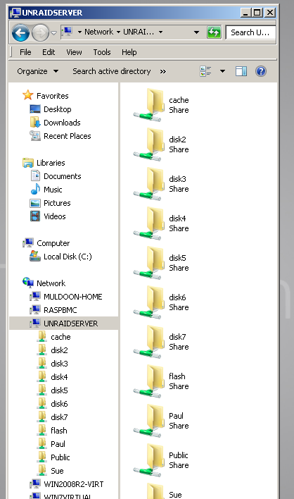

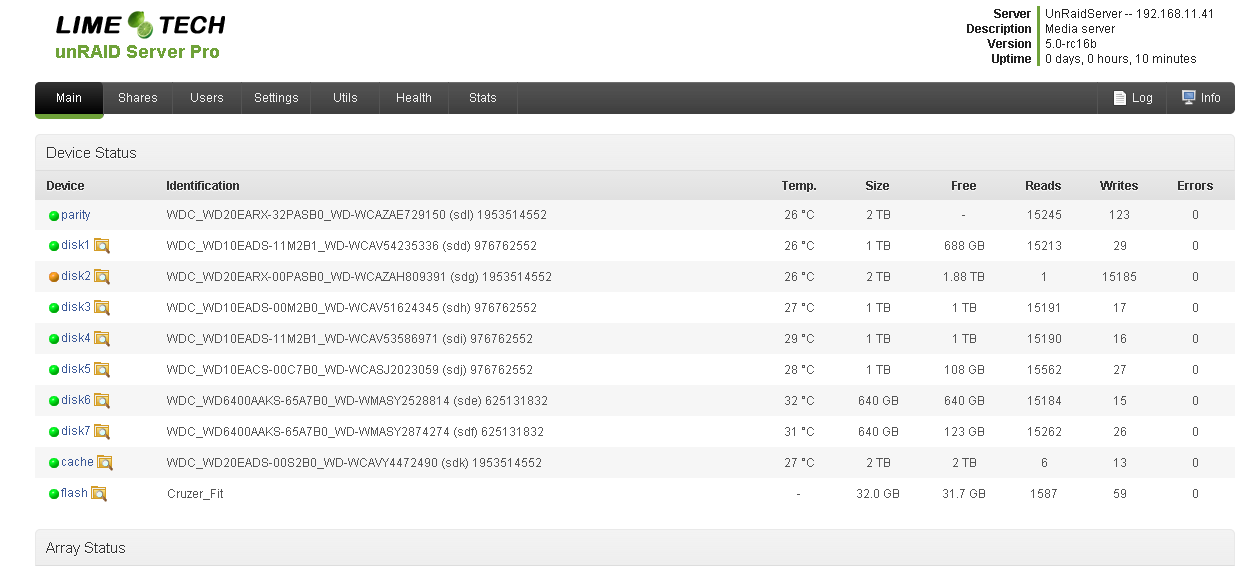

And I'm close to back and running, with no real (or important) data loss.  But I've noticed in my network setting that I'm missing Disk1 in my network.  The best way to really show is via screen shots.
In Unraid, you see disks 1-7, but my network is missing Disk1.
Any ideas on its cause?

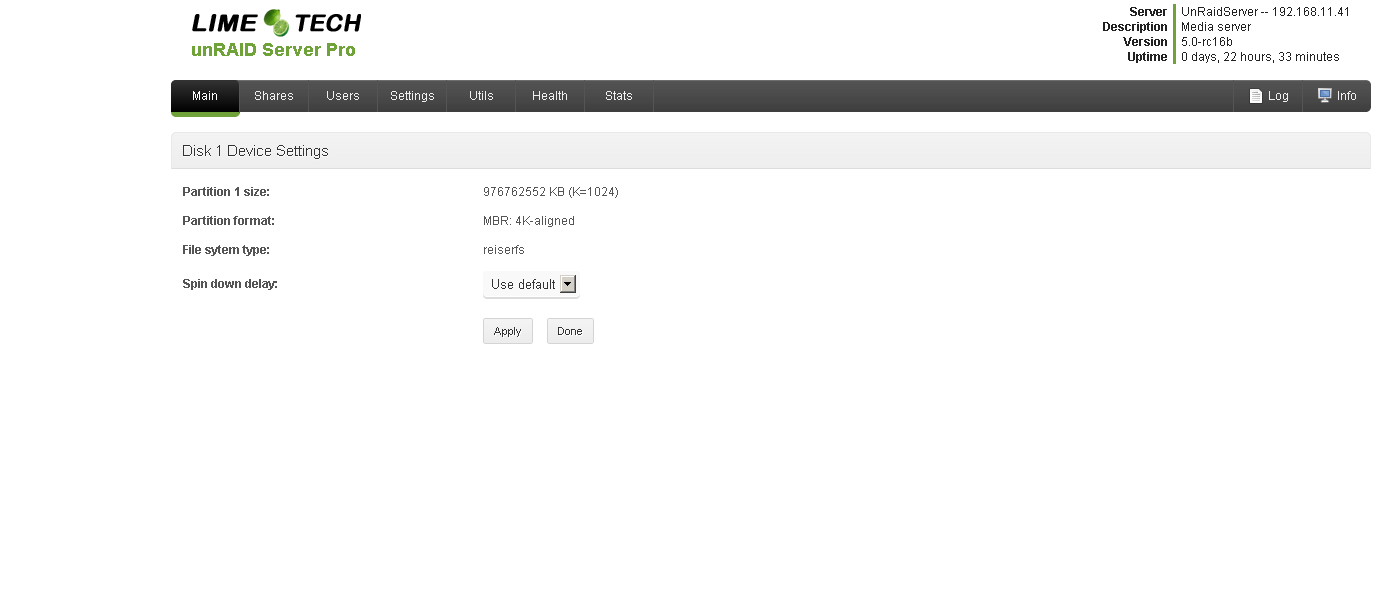

Johnathanm.    I'm pretty sure this is an issue/bug with SimpleFeatures.  Take a look at the link I posted earlier.  This a screenshot of Disk1.  It looks like only the flash disk is the only one that shows the SMB options.
