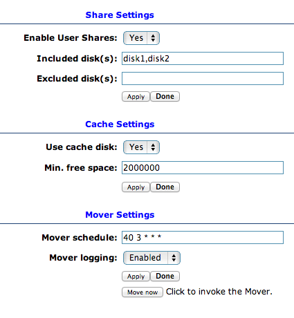

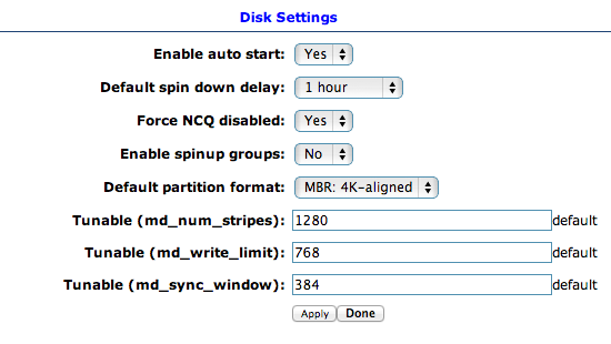

If the files are written in /Volumes/movies and not a subdirectory, e.g. /Volumes/movies/new/moviefile.mkv, then split level one is sufficient. What does Settings->Disk Settings show?
Attached screen shot...
Bear in mind I've put the config back to the way it was before.  Before I had the "Included disk(s)" blanked.
That looks like the global settings screenshot for user shares - not those for a specific share.
To achieve what you want I would expect the global settings for user shares to not limit the included shares, but those for individual shares to have included disk limits.
As noted above, you've configured the global settings for shares to only use disk1 and disk2 ... so no share can write to any other disk.    You normally do NOT want to use includes or excludes on the global settings page -- only for the individual shares.
I suspect that's exactly what's wrong here.    Just remove the includes from this page and all should be well.  If you have other shares you want to limit to disk1 and disk2, do so on their individual share properties page.
Oh, good grief.  That worked.  The only think I can think of that I did differently was have the share settings included disks as blank BEFORE I created the share.  Guess I have some more options now.  Thanks!
