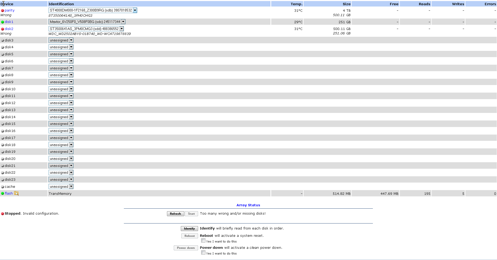

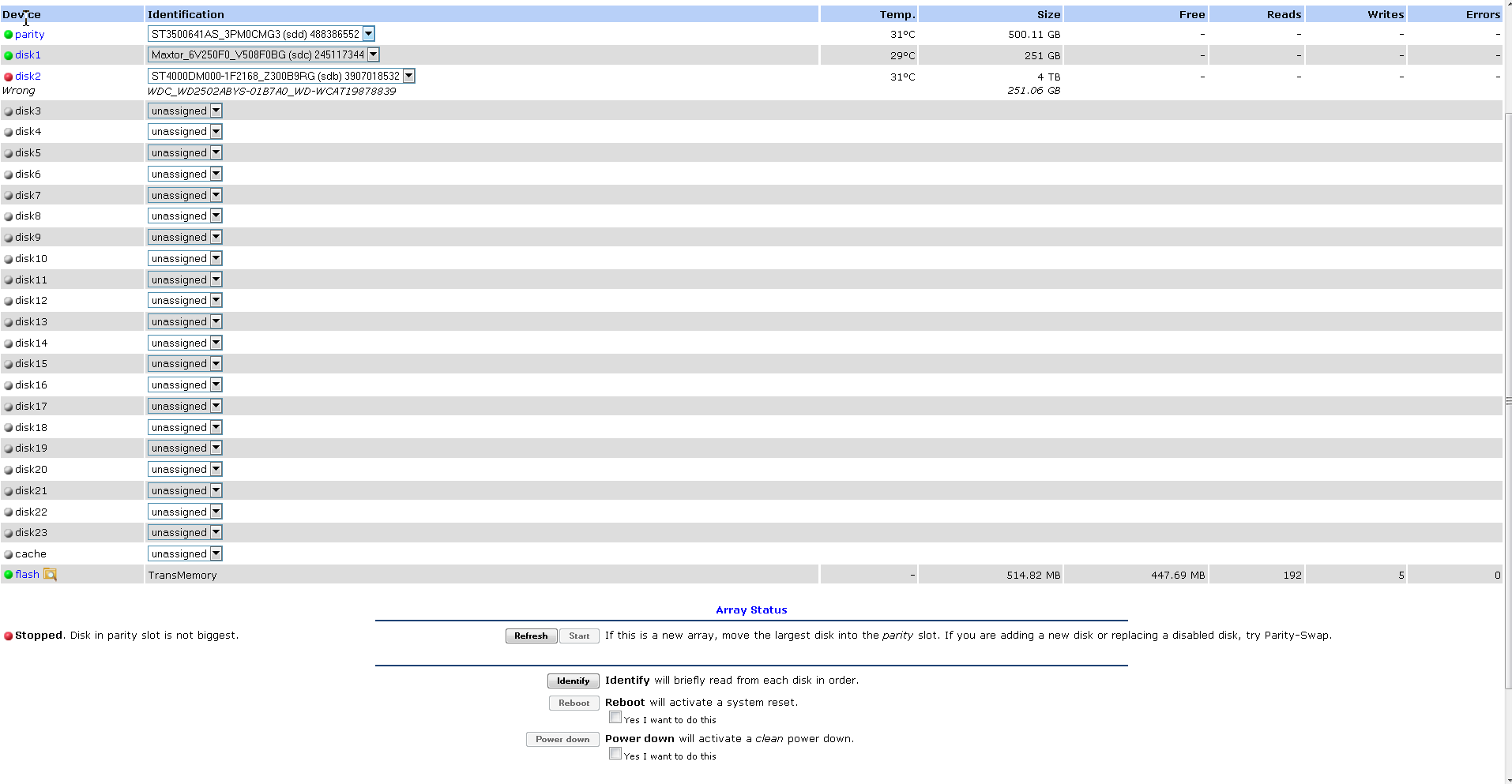

Does the missing drive have a red ball? Attach a screen shot. I believe that once the disk assignments have been made, starting the array will begin the copy procedure. Where did you read about the "copy" button.
Here are the screenshots
Trying to find that thread with the "copy button" but its not so easy...

After assigning the disks I cannot start the array.
I gave up last night.
My intention was to use the "missing" drive as a cache drive and simultaneusly put the new 4TB parity drive in use.
But obviously there seems to be an issue with the "parity-swap" function.

Agree, this procedure exists and the screenshots I provided in my prior post show that but it doesn't work. In my screenshots you can also see that the data drive is redballed.
And after doing the parity drive swap nothing happens!
