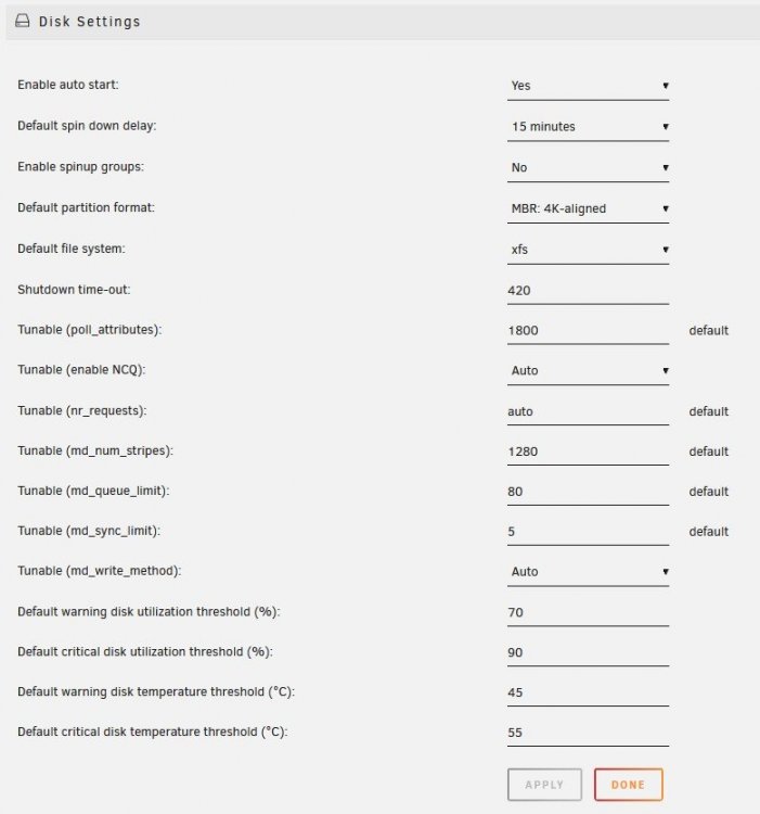

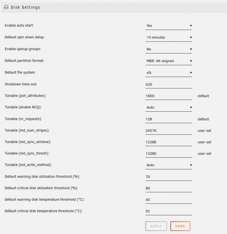

For the new UTT v4.1, the output is saved to the current directory when you launch UTT.  The report will be named based upon the test type you chose (i.e. NormalSyncTestReport_<datestamp>.txt).  There is also an identically named CSV file generated that has all of the test results in spreadsheet format, making for easier charting of results.
When the tests complete, you are provided the option to apply the Fastest, Thriftiest, or Recommended values that were discovered, or revert back to the previous values.  In addition, if you apply new values, you are also given the option to SAVE the chosen values to the server's configuration, so it will re-apply after reboot.
You can also manually apply your chosen values later by going to Settings > Disk Settings.
The Fastest values represent the combination of Tunables that resulted in the fastest measured Parity Check speeds.  If the fastest speed was observed in multiple combinations of values, then the combination that has the lowest memory utilization is chosen as the fastest.
The Recommended values are the combination of values with the lowest memory utilization that achieves at least 99% of the Fastest speed.  Often this provides a nice memory savings over the Fastest values, while only adding a few seconds or minutes to a full Parity Check.
The Thriftiest values are the combination of values with the lowest memory utilization that achieves at least 95% of the Fastest speed.  These usually provide a significant memory savings over the Fastest values, but might make your Parity Checks noticably longer.
In case you're wondering, the formula for assigning the four Tunables values is of my own design.  It tests a whole bunch of values for md_sync_window, assigns md_num_stripes as 2x md_sync_window, and tests various methods of assigning md_sync_thresh (md_sync_window -1, -4, -8, -12, -16, -20, -24, -28, -32, -36, -40, -44, -48, -52, -56, -60, -64, and md_sync_window/2) and optionally various values for nr_requests (128, 16, and 8).  If nr_requests is not tested, then all tests use nr_requests=128, which typically provides both the fastest speeds and the most obvious speed curves, making it easier to find the best values for the other three Tunables.
It should be noted that low values for nr_requests (i.e. nr_requests=8 ) seems to make all values for the other Tunables perform really well, perhaps 90-95% of maximum possible speeds, but in our testing we have always found that the maximum possible speeds come from nr_requests=128.  For this reason, all of the default tests are performed at nr_requests=128, and we make the nr_requests tests optional (Through or Xtra-Long tests).  In our experience, after the other values have been properly tuned for your server, these optional nr_request tests of lower values will only show slower speeds.  That said, it is possible that your server hardware responds differently, and the only way to know for sure is to run these optional tests.
