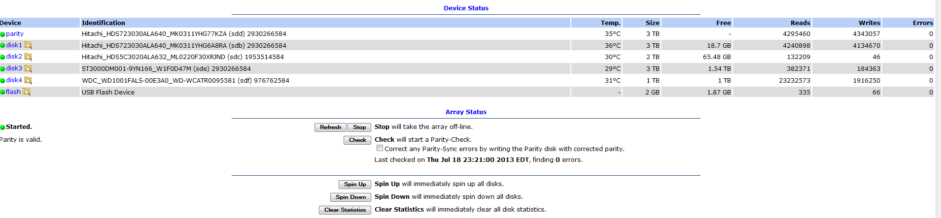

I'm trying to transfer some more TV shows to my unRAID server, but I keep getting an error indicating that I'm out of space.  But if I look at the disk usage, it says I have ~2.5TB of free space.  For some reason, it appears to try and put the TV shows I'm trying to transfer on Disk 1, as opposed to using free space on the other disks.  Can anyone help me with this?
Depending on your tv show folder structure and split level setting, you might be forcing all the episodes to stay in the same folder and that folder happens to be on the disk that is out of space.
Agree -- it's hard to say for sure without seeing the folder structure you're using; but I suspect the split level of 2 is such that it's forcing the writes to be on disk1 ... which is out of space.
A trivial way to confirm this is the issue:  Delete the split level for the share (just leave it blank), then try it.

That still might not work if the file being written starts as zero length file and is gradually appended as it is created.  It will fit on the disk with limited space, but not be able to fit once it grows.    Only way to fix that is to set the Min Free Space to a value LARGER than the largest file typically copied to the disk.
